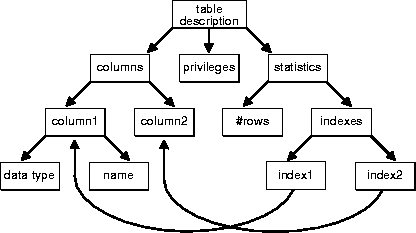

The information returned by OCIDescribeAny() is organized hierarchically like a tree. For example, Figure 6-1 shows how the description of a certain table might be organized.
The describe handle returned by OCIDescribeAny() points to such a tree of descriptions. Each node of the tree has attributes associated with the node and attributes (which are like recursive describe handles) that point to subtrees containing more information. If all the attributes are homogenous, as in case of elements of a list, such as a column list, then we refer to them as parameters. In this chapter, the terms handle and parameter are used interchangeably. The attributes associated with any node are returned by OCIAttrGet(), and the parameters are returned by OCIParamGet().
For example, an OCIAttrGet() on the describe handle for the table can return a handle to the column-list information. An application can then use OCIParamGet() to retrieve the handle to the column description of a particular column in the column-list. The handle to the column descriptor can be passed to OCIAttrGet() to get further information about the column, such as the name and data type (as illustrated by following the left-hand side of the above figure).
No subsequent OCIAttrGet() or OCIParamGet() call requires extra round trips, as all the description is cached on the client side by OCIDescribeAny().
