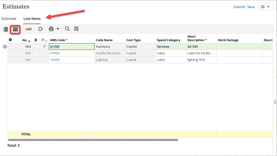

Adding and Managing Line Items Using the Grid View Feature
For Line Item business processes, the system provides a grid feature (Grid View) that shows the line-item entry form in a lateral sheet view, where you can enter the data directly without having to open a line item form. In this regard, the sheet works the same way the line-item entry form works—rows might not be editable because of their statuses, auto-populated fields will be filled in for single-record BPs, if a yet-to-buy amount has already rolled up from a cost BP to the cost sheet, you will not be allowed to modify the line item, etc.
Note: The Grid feature is best used for short line items.
The following shows the Standard View of the Grid View:
If a line item has any attachments, you will see a paper clip icon next to the line item number, which you can click to view a list of all attachments connected to the line item. If a line item has been linked to another business process record, a link icon will appear in the column directly to the right of the attachments column. If you scroll to the right, you can see the total amount of all line item attachments in the BP record.
Note: Attachments, linked records, and the Total Amount will only be visible if the BP has been designed to allow these line item fields.
The grid feature (Grid View) shows the line item number and all the fields on the line item entry form, including fields that are required, formulaic, or populated, as well as fields that are part of a dynamic data set. The fields on this grid work the same way they do on a line item entry form—pickers display picker windows, menus display lists, formula fields produce calculations, date picker fields display calendars, etc.; however, radio buttons will appear as pull-down menus, and image, hyperlink, and BP Creator fields have special behaviors.
You can resize the columns by dragging, and sort the data by column (except for Row and image fields). You can use the Tab and arrow keys to move from field to field and open them. For business processes that include many line items, you can use the Search function to filter the list to display only certain line items.
