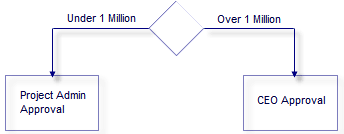

This graphic displays how a condition can trigger two different steps if the amount is more or less than a set amount.
When the workflow reaches a conditional step, the business process tests the value of the field on the form to see whether or not it meets the trigger value.

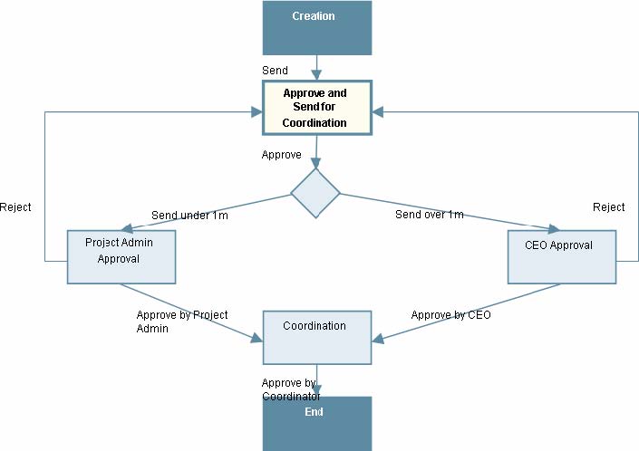

    This image depicts an example conditional workflow.
