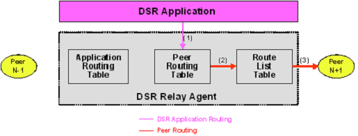

Request Routing
Figure 2-17 shows the case where Diameter Request messages are routed from the Diameter Routing Function to the PCA based on the configured Application Routing Rule, and routed from the PCA to the Diameter Routing Function, all using the Application-Data function. The PCA will return the Request to the Diameter Routing Function for Peer Routing Rule processing and routing.
Figure 2-17 Request Processing at the Diameter Routing Function and PCA
img/request_processing_at_drf_and_pdra.png

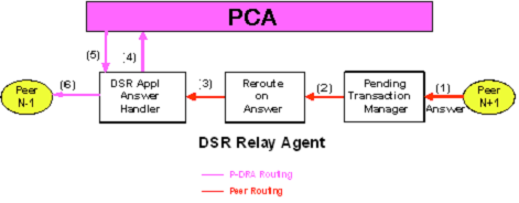

Answer Routing
When the PCA forwards a Request message to the Diameter Routing Function for routing, it must inform the Diameter Routing Function how to process the corresponding Answer. It can inform the Diameter Routing Function either to route the Answer to the PCA or to route the Answer to the downstream Peer without involving the PCA. Figure 2-18 shows the case where an Answer is transmitted back to the PCA. After the PCA completes processing of the Answer, it will send it to the Diameter Routing Function for transmission to the Diameter Transport Function so that it can be routed to the downstream Peer.
Figure 2-18 Answer Processing at the Diameter Routing Function and PCA
img/answer_processing_at_drf_and_pdra.png

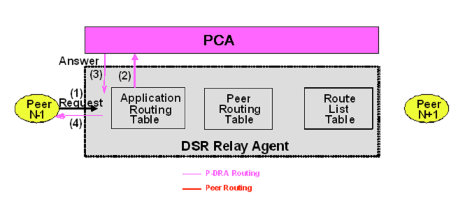

PCA Generated Answer
In some cases, the PCA needs to generate an Answer message in response to an incoming Request. For example, the Policy DRA function cannot find a PCRF to route the Request message to. Figure 2-19 shows the Diameter Routing Function routing for this scenario.
Figure 2-19 PCA Generated Answer Routing
img/pdra_generated_answer_routing.png
