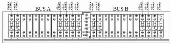

  2. For each breaker assignment, verify the corresponding LED in the PWR BUS A group and the PWR BUS B group is illuminated green.
    Figure 3-2 Breaker Panel Setting
    img/t_3000000002000000_breaker_panel_breaker_error-breaker_panel_settings.jpg

  3. Check the BRK FAIL LEDs for BUS A and for BUS B.
    • If one of the BRK FAIL LEDs is illuminated red, then one or more of the respective Input Breakers has tripped. (A tripped breaker is indicated by the toggle located in the center position.) Perform the following steps to repair this issue:
    1. For all tripped breakers, move the breaker down to the open (OFF) position and then back up to the closed (ON) position.
    2. After all the tripped breakers have been reset, check the BRK FAIL LEDs again. If one of the BRK FAIL LEDs is still illuminated red, run syscheck and contact My Oracle Support.
