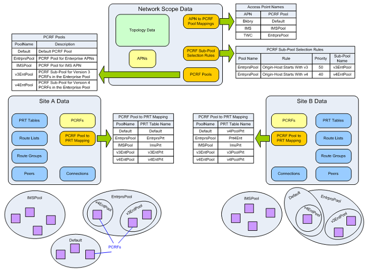

pcrf-pools.html#GUID-1FB735E4-CBAE-450A-80B8-93CBC4982DBF__V5691418 illustrates a sample PCA network configured for PCRF Pooling. The upper third of the figure shows data that is configured with the Policy and Charging GUI at the NOAM server. This data, including PCRF Pools, APN to PCRF Pool mapping, and PCRF Sub-Pool Selection Rules applies to all sites in the Policy DRA network.
The middle third of the figure shows data configured at the SOAM Policy and Charging GUI at each of two PCA sites. This data includes the PCRF Pool to PRT mappings, PCRFs, PRT tables, Route Lists, Route Groups, Peer Nodes, and Connections. This data can differ at each PCA site.
The bottom third of the figure shows the PCRFs logically grouped into PCRF Pools as defined by the network operator.
Figure 5-2 PCRF Pooling Data
