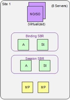

The configuration of the smallest viable commercially deployable PCA DSR, illustrated in , has enough hardware redundancy to support in-service maintenance:
  • Two DA-MPs are required to survive server failures and maintenance. These DA-MPs should be engineered at 40% load since in a failure or maintenance situation, one Server will have to handle the load for both.
  • Both binding and session SBR Servers pairs use the Active/Standby redundancy model in order to support failures and maintenance.
  • The NOAM/SOAM Server pair uses the Active/Standby redundancy model in order to support failures and maintenance.
  • Both NOAM and SOAM are virtualized onto a single pair of physical servers. The NOAM instance is Active on one server and Standby on the other. The SOAM instance is Active on one server and Standby on the other.
Figure 2-8 Smallest Supported PCA Field Deployment
img/smallest_pca_supported_deployment.jpg

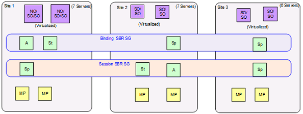

The smallest supported mated triplets of PCA DSRs, illustrated in , has certain characteristics:
  • The NOAM servers are deployed at Site 1 using Active/Standby redundancy.
  • The Site 1 SOAM server are deployed at Site 1, virtualized on the same servers with the NOAM servers. However, the use the Active/Standby/Spare/Spare redundancy model, with the spare server deployed at Site 2 and Site 3 and virtualized on the same server with one of the Site 2 SOAM servers.
  • The Site 2 (and Site 3) SOAM servers are deployed at Site 2 (and Site 3) using the Active/Standby/Spare/Spare redundancy model. The spare Site 2 SOAM server is virtualized at Site 1 on one of the servers already hosting an NOAM and a Site 1 SOAM server.
  • A binding SBR triplet is deployed with two servers at Site 1 and one server each at Site 2 and Site 2 respectively.
  • A session SBR triplet is deployed with two servers at Site 2 and one server each at Site 1 and Site 3 respectively.
  • Two DA-MP servers are deployed at each site to support server redundancy at each site.
Figure 2-10 Smallest Supported PCA Mated Triplets
img/smallest_pca_mated_triplets.png
