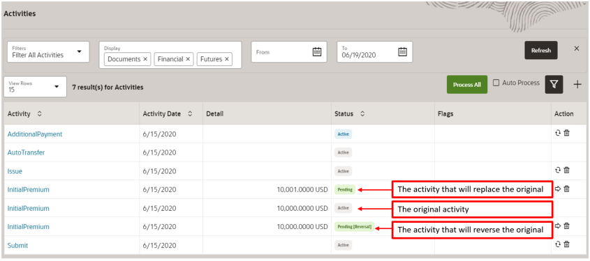

Shadowed Status
An activity is in shadowed status when it has been recycled or deleted.
Clicking the Recycle
icon associated with an activity creates two
additional activities to be processed. The first is a reversal activity that has Pending [Reversal] status. The second activity is the new activity that has Pending status and it replaces the original activity when the reversal activity is processed.
Step 1: Click the Recycle
icon for an activity.
Two pending activities are generated in OIPA: reversal activity and new activity.
Two Pending Activities Generated For Recycle

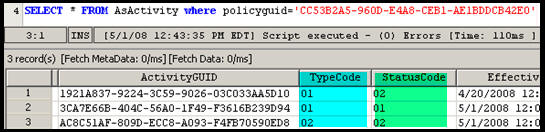

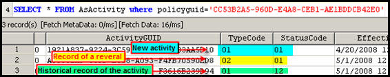

- Two additional records are written to the database to track the reversal and new activity.
Reversal Records Written to Database

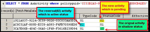

Step 2: Click the the Process
icon for the reversal activity.
The status of the original activity is updated to shadow and the reversal activity status is updated to active.
Active Reversal Activity
- The status of the original activity’s record changes from 01(active) to 12(shadowed). The reversal activity changes from 02(pending) to 01(active).
Reversal Activity in the Database
Step 3: Click the Process
icon for the new activity that has the correct information.
The activity’s status changes from pending to active. The new activity’s status changed from 02(pending) to 01(active).
Explanation of Reversal Records in Database

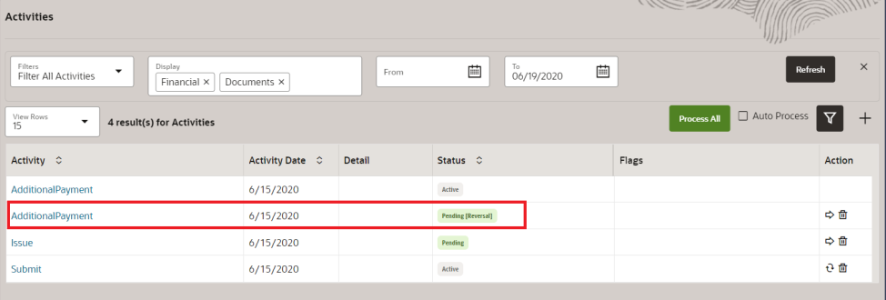

Clicking the Reverse
icon associated with a processed activity generates a reversal activity. The reversal activity is in Pending [Reversal] status and must be processed in order to delete the activity and place it in a shadowed status.
Step 1: Click the Reverse
icon associated with an activity. A reversal activity is generated with a Pending [Reversal] status.
Reversal Activity in Pending Status

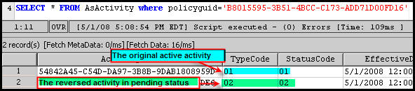

- There are now two records, one for the original activity and one for the reversal activity.
Two Reversal Activities in Database
Step 2: Click the Process
icon for the reversal activity. The original activity is then updated to shadowed status and the reversal activity is updated to active status. The database record for the original activity is updated to 12(shadowed) and the reversal activity is updated to 01(active)status.

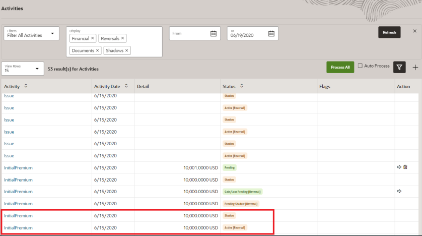

Important: The delete display filter does not control the viewing of deleted activities. An activity that is deleted will have a shadowed status. Select the filter for shadowed activities to see those activities that were deleted. This filter displays the ability to delete activities via the trash can icon. The delete option should not be available in a production environment.
