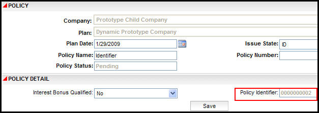

View this configuration in OIPA by logging into the Company | Plan you identified in the steps above. Create a new policy. Add policy details and click the Save button. The identifier field should be disabled and should show the unique ID generated by the system.
Identifier Field on Policy Screen
