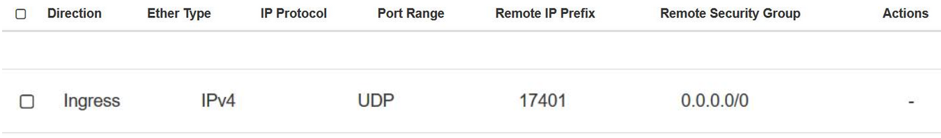

tcpdump -i eth1 -n "host <server-A>-imi or <server-B>-imi and port 17401 and udp"For example:
tcpdump -i eth1 -n "host noam00-17badf67-imi or noam01-17badf67-imi and port 17401 and udp" - If ping request or response packets are not coming
from any server, then add security group rule ingress (response) or egress (request)
to that instance.
The following image shows Ingress response:
Figure 21-1 Ingress Response

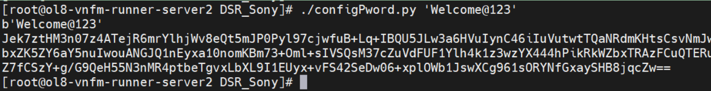

- The updated password must be encrypted using the utility function which
is
/configPword.py'passwordToBeEncrypted'.Following is an example showing the usage of the script:
Figure 21-2 Usage of Script
