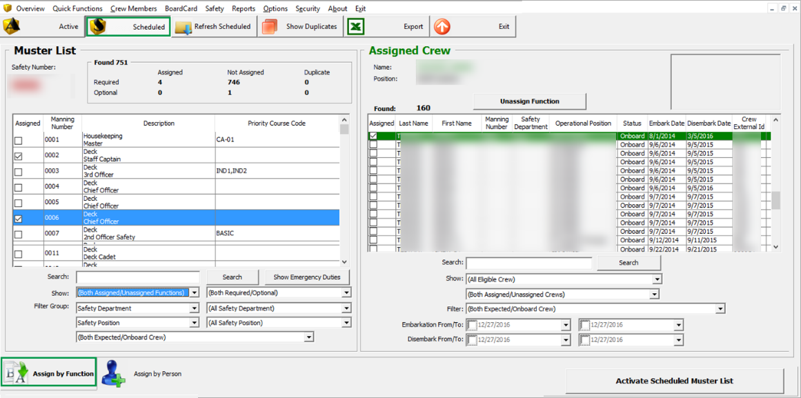

In the Assign by Function tab, you will see a summary of assigned/not-assigned count, with a list of all Safety Numbers associated to a position of the Muster Station underneath it.
In the Eligible Crew section, lists of crew matching the eligibility criteria and to be assigned to the Safety Number is shown. A list of courses taken is shown in the grid if this is defined in the Safety, Display Valid Courses on Muster List Assignment parameter.
Save Active Muster List: Saves all current safety number assignments as backup in a text file format.
Reload Active Muster List: Allow restoration of backed up safety number assignments based on the saved muster list file. You can use this function to undo all the changes after activating the Schedule Muster List.
In the Muster List Assignment window, click Active and Assign by Function.
Select the criteria from the drop-down list.
To view more information about the selected Safety Number, click the Show Emergency Duties.

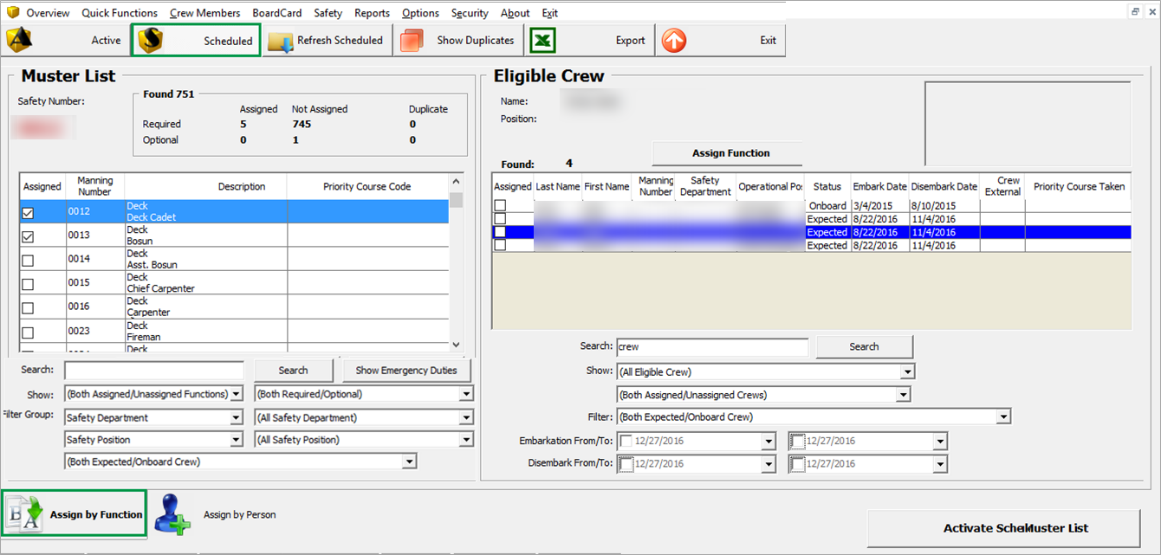

This function allows Safety Officers to plan ahead and assign a safety number in advance, allowing the arriving crew to replace crew members due to disembark.
In the Scheduled tab, the system checks and ensures only qualified Onboard and Expected crew members are assigned to the specific emergency functions.
The assignment of Safety number per crew or by onboard/expected is managed by the Safety, Allow Safety No Assignment to Onboard or Expected parameter. See Appendix — Parameter for further details.
Figure 5-11 Standard Schedule Muster List — Assign by Function
Figure 5-12 Advance Schedule Muster List — Assign by Function
The information displayed in the Assign by Function tab is similar to Active Muster List and has an additional filter by Embarkation From/To and Disembark From/To in the Eligibility section.
In the Muster List Assignment window, click Schedule.
Navigate to the Eligible Crew section and further filter the information to display.
Double-click the crew name to view the Crew Eligibility Status and course history.
Select the crew name and click Assign Function.
At the confirmation prompt, click Yes to proceed. This places a check mark on the Assigned column or No to return to the previous window.
Select the crew you want to un-assign and click Unassign Function.
