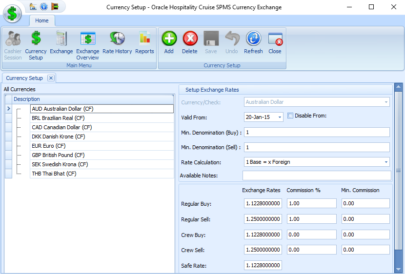

Currency Code and Exchange Rate Setup
You will need to have a Credit Posting department for each currency accepted by the ship. This is set up in Administration module, Financial Code setup. See Administration User Guide for more information on how to setup the codes.
Set up the Financial Codes, you can then enable the currency code and set the exchange rate in Currency Exchange module.
Figure 2-1 Currency Setup

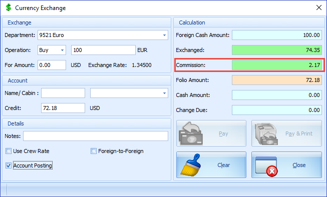

To exchange €100 to USD that has applicable commission at 3 percent. The calculation formula is (€100/1.345) = $74.35. Hence the applied commission is $2.17 ((€100/1.345)/3%)).
Figure 2-2 Commission by %

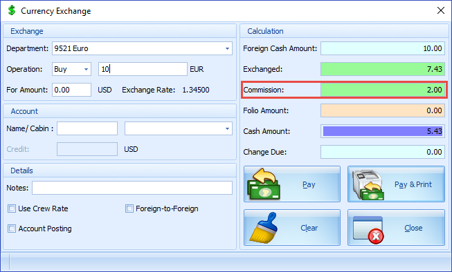

To exchange €10 and minimum commission is $2.00, the calculation formula is (€10/1.345) – $7.43 x 3% = $0.0223. Since the calculated value is below the amount specified, the system will post $2.00 as the applicable commission. Hence, the guest only receives $5.43.
Figure 2-3 Minimum Commission Charged
