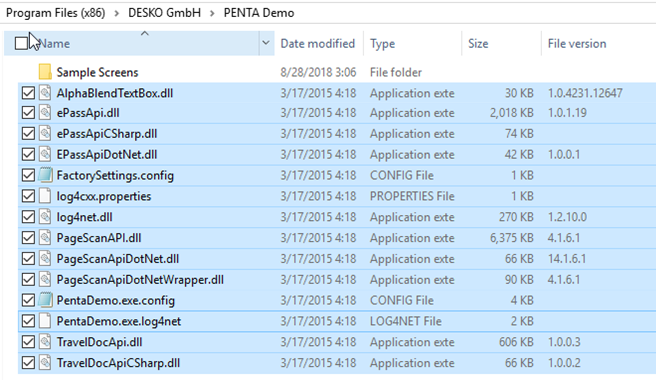

Navigate to C:\Program Files (x86)\DESKO GmbH\PENTA Demo folder and copy all the DLL files to C:\Windows\SysWOW64 and C:\Program Files (x86)\Oracle Hospitality Cruise folders. See below diagram for list of DLL’s
Figure 5-1 PENTA Path for Gen 4 Device

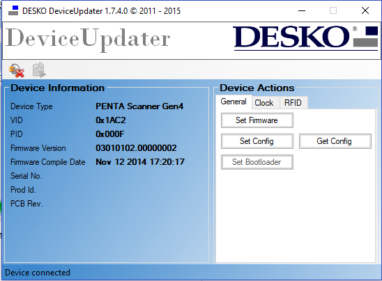

Locate DESKO GmbH – DESKO Devices from the Windows Start option and select Device Updater or double-click the DeviceUpdater.exe. Below are the file paths of the Device Updater.
DESKOSW_6010404000_PENTA_Full_Installer Penta CKI (For Gen 4 device) C:\Program Files (x86)\DESKO GmbH\Device Updater folder.
The update tool automatically scans for installed devices and prompts a message for every Desko device detected.
Figure 5-2 Device Information Page

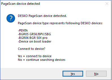

At the PageScan device detected window, click Yes to connect the device.
Figure 5-3 DESKO PageScan Device Detected
