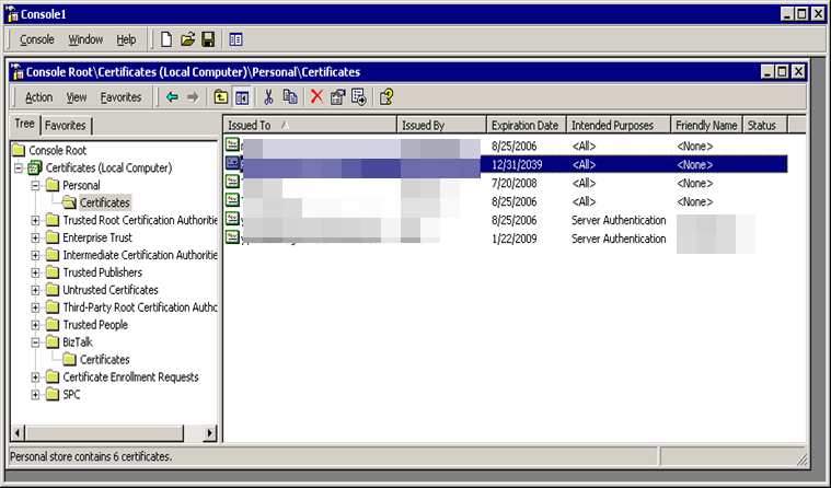

When opening the MMC for “Local Computer” certificates, you should see something similar to Figure 1–1 Console Root Window below. Notice the Certificates (Local Computer) / Personal / Certificates
is showing the new certificate.
Figure 1-1 Console Root Window
When opening up the details of the certificate, you can see at the bottom, “You have a private key that corresponds to this certificate.” This means the OS Key Container public/private keypair is associated with the certificate in the Certificate Store, and you can decrypt items as they come into this “BizTalk” Node.

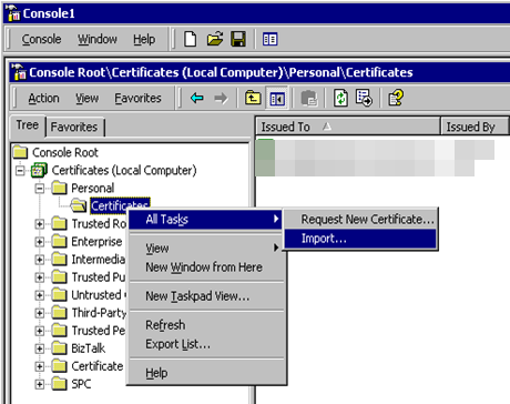

Console Root\Certificates (Local Computer)
, right-click the Other People folder.
