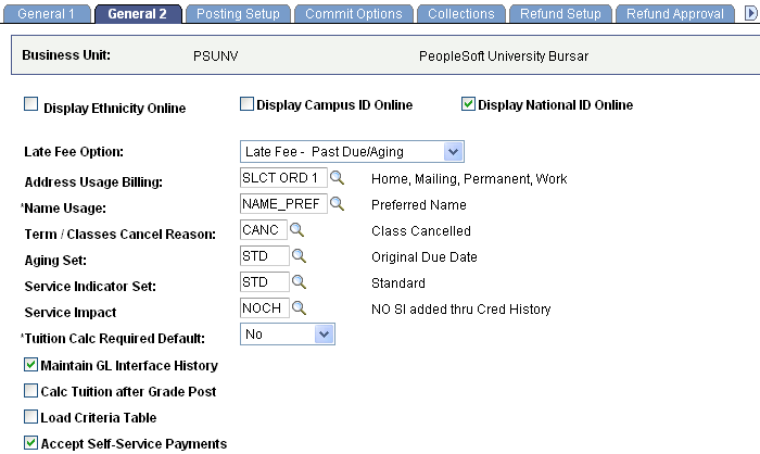

General 2
BUS_UNIT_TBL_SF2
Set Up SACR > Product Related > Student Financials > SF Business Unit > General 2
Define additional business unit parameters.

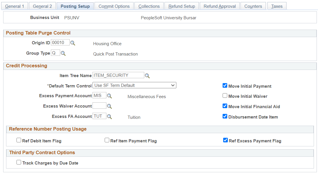

Posting Setup
BUS_UNIT_TBL_SF14
Set Up SACR > Product Related > Student Financials > SF Business Unit > Posting Setup
Define posting parameters.

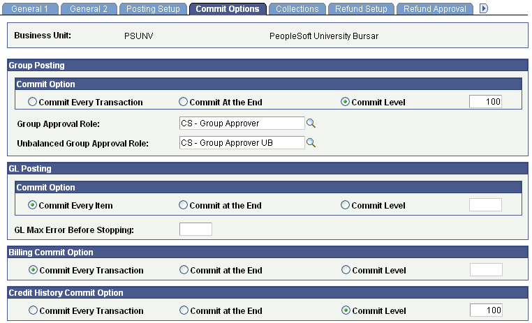

Commit Options
BUS_UNIT_TBL_SF10
Set Up SACR > Product Related > Student Financials > SF Business Unit > Commit Options
Define committal and approval options.

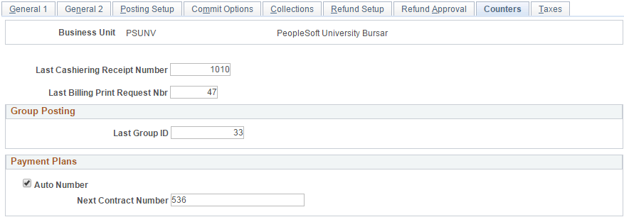

Counters
BUS_UNIT_TBL_SF8
Set Up SACR > Product Related > Student Financials > SF Business Unit > Counters
Define auto-numbering sequences.

Access the General 2 page (Set Up SACR > Product Related > Student Financials > SF Business Unit > General 2).
This example illustrates the fields and controls on the General 2 page. You can find definitions for the fields and controls later on this page.
General 2 page
Field or Control
Description
Display Ethnicity Online
Select this option if you want the student's ethnicity to appear on the Academic Information page.
Display Campus ID Online
Select this option if you want the campus ID to appear on the Academic Information page. The campus ID identifies the campus, not the student.
Display National ID Online
Select this option if you want the student's national ID (for example, social security number) to appear on the Academic Information page.
Late Fee Option
Select one of two Late Fee - Billing methods: Late Fees - Bill Request Nbr or Late Fees - Past Due/Aging.
Late Fees run control pages use this option to verify that the correct process is used before processing.
You can use two distinct processes to calculate late fees. One method is based on the account aging or the due date. The other method is based on a billing request number using the amount billed as a basis.
Address Usage Billing
Select a default address usage type to use when you generate customer bills.
Name Usage
Select a default name usage type.
Term/Class Cancel Reason
Select a term/class cancellation code that you want to use as the default reason when you run the Term/Class Cancellation process.
Aging Set
Select the aging set that the system uses by default for the Assign Collector process.
Service Indicator Set
Select the service indicator set to use. This service indicator set must include all service indicators that you want to use for credit history processing.
Service Impact
Select the service impact to use to stop a service indicator from being placed by the credit history process. This is a default value that isx used when credit history is called from the self-service pages.
Tuition Calc Required Default (tuition calculation required default)
Select Yes if you want the Tuition Calc Required flag set automatically when a student is activated in a term. Use this option if you want tuition to be calculated on Anticipated Units.
Select No if you do not want the Tuition Calc Required flag set automatically when a student is activated in a term. Use this option if you want tuition fees calculated only after enrollment activity (Bill Units).
Maintain GL Interface History
Select this option if you want the system to maintain general ledger interface history. This selection is required for you to use the Back Out GL Interface functionality.
Calc Tuition after Grade Post (calculate tuition after grade post)
Select this option if you want the Tuition Calc Required flag to be set to Yes whenever student grades are posted or changed through the Grade Roster page.
Note: This check box does not affect the Tuition Calc Required flag being set to Yes when grades are posted or changed through the Enrollment pages.
Load Criteria Table
Select this option if you want the criteria tables (for example, Career, Program, Fee Triggers, and so on) to be loaded into working storage at the beginning of the Tuition Calculation process. If you are using a large number of waiver criteria, fee triggers, and criteria for tuition groups, selecting this option can improve Tuition Calculation process performance.
Note: If more than 1000 total criteria values exist, this option must not be selected. Working storage is currently limited to 1000 maximum values.
Accept Self-Service Payments
Per SF business unit, select this option to allow students to make payments through self service. When you select this option, it appears on the Institution Set > Business Units > Accept Self-Service Payments page.
See Setting Up Institution Sets.
Access the Posting Setup page (Set Up SACR > Product Related > Student Financials > SF Business Unit > Posting Setup).
This example illustrates the fields and controls on the Posting Setup page. You can find definitions for the fields and controls later on this page.
Posting Setup page
Field or Control
Description
Default Term Control
Select a value on which to base the term.
The values are:
  • Latest Enrollment Term. Select if you want the default term to be based on the maximum term from STDNT_CAR_TERM where the eligible to enroll check box is on. If that does not return a term, then the default term is based on the term value defined in the SF Term Default setup.
  • Most Current Enrollment Term Select if you want the default term based on the term from STDNT_CAR_TERM with a begin date of less than equal to the current date. If that does not return a term, then the default term is based on the term from STDNT_CAR_TERM where the end date is greater than or equal to the current date. If this does not return a term, then the default term is based on the term value defined in the SF Term Default setup.
QUICK_POST_TBL Purge Control
Student Post (Quick Post) and Corp Post transactions are recorded in the Quick Post table. These entries can be consolidated into posting groups using the Purge QUICK_POST_TBL process. The options in this group box create entries in the Group Control record that enable you to easily track Student Post transactions.
Field or Control
Description
Origin ID
Select the origin ID that you want the system to use when consolidating transactions into posting groups.
Group Type
Select the group type that you want the system to use when consolidating transactions into posting groups.
Credit Processing
Set the conditions that you want the system to use when credits (payments) are posted on an account.
Field or Control
Description
Item Tree Name
Select the name of the item type tree that contains all of the item types that you use for transactions. This tree also controls item type security.
Select how you want to determine the term that the system uses as the default if a charge or payment is entered without specifying a term.
Note: Values for this field are delivered with your system as translate values. Do not modify these values in any way. Any modifications to these values require a substantial programming effort.
Warning! Your selection of a default term control can affect how payments are processed. When either of the enrollment term selections are used, the actual term value may vary from student to student. The actual term value used becomes the value of the current term for payment processing.
Values are:
Last Enrollment Term: Select if you want the default term to be based on the student's most recent completed term of enrollment.
Most Current Enrollment Term: Select if you want the default term to be based on the student's most recent term of enrollment, whether completed or not.
Use SF Term Default: Select if you want the default term to be based on the term value that you defined in SF Term Default setup.
Move Initial Payment
Select to move all payments in excess of charges to the account specified for excess payments. If the option is not selected, excess payments show as a credit balance on the charge account.
Excess Payment Account
Select a default account that you want to use for payments that are received in excess of charges.
Move Initial Waiver
Select this check box only if you need to move all waivers posted through Student or Group Post that are in excess of charges to the account specified for excess waivers.
Using the tuition calculation process for waivers should never create a waiver with a credit balance. Oracle recommends that you don’t select this option when waivers are calculated and posted using the tuition calculation process. To post unique and discretionary waivers, see Assigning Student Waivers.
Excess Waiver Account
Select a default account that you want to use for waivers that are posted to an account in advance of charges. This feature can also be used as an option for waivers that are posted in excess of charges.
Warning! Oracle doesn’t recommend using this option. Waivers should rarely, if ever, be applied to students’ accounts by any means other than the tuition calculation process. Waivers posted using the Student Post or Group Post processes may not be adjusted properly and may not be applied according to the payment applier rules.
For example, a waiver that exceeds student charges is a stipend and it may be considered taxable income by the governing tax authority. Tuition calculation is a self-correcting process; it ensures that no more than 100% is ever waived. If you use Student or Group Post, you’re removing this protective measure.
When a waiver is posted in excess of charges, it doesn’t appear in box 1 on the US tax form 1098–T or the Canadian tax form T2202.
For information about posting discretionary waivers that don’t fit your standard waiver setup or criteria, see Assigning Student Waivers. Use that feature instead of Student Post or Group Post.
Move Initial Financial Aid
Select to move all financial aid payments in excess of eligible charges to the account specified for excess financial aid. If this option is not selected, excess financial aid payments show as a credit balance on the charge account.
Excess FA Account (excess financial aid account)
Select a default account that you want to use for financial aid that is posted to an account in excess of eligible charges.
Disbursement Date Item
Select if you want the system to display each disbursement of a financial aid award in a single term (same item type) as a separate line item on a student's account. Also, selecting this option enables the system to identify specific disbursements in the event that an adjustment is required.
For example, if a direct loan requires more than one disbursement in one term, selecting this check box identifies each disbursement with a unique date causing the system to recognize each as a separate entry.
Clear this option to have all disbursements in a term roll into one line item.
Note: After you begin posting financial aid awards, you should not change this setting.
Warning! Financial aid disbursement does not correctly reverse disbursements when multiple disbursements exist within a term and you do not select the Disbursement Date Item check box. This can occur, for example, if multiple disbursements are in a single term and one or more of them is reduced. If you use batch disbursement to post the new disbursement amount, the posting process reverses the entire disbursement total for the term and then reposts only one of the disbursements in the term. In PeopleSoft Financial Aid, the disbursements look like they have been disbursed properly, but in Student Financials only one of the disbursements is properly posted, so the two applications are out of sync. If you use online disbursement to update the newly reduced disbursement amount, the same problem occurs. The online disbursement process reverses the entire award amount for the term and posts only the new reduced single disbursement amount.
Reference Number Posting Usage
This group box provides additional options for the posting of debits and payments.
Field or Control
Description
Ref Debit Item Flag (reference debit item flag)
Select to have the option of associating a reference number with charge items. For example, you could use a parking ticket number as a reference on a parking fine charge. Each charge item with a reference number is displayed separately on the Charge Detail page.
Ref Item Payment Flag (reference item payment flag)
Select to have the option of associating a payment with a particular charge by using the reference number. For example, if you use a parking ticket number as a reference number on a parking fine charge, you can use that same ticket number to tie the payment to the specific charge.
Note: The Ref Debit Item Flag check box must be selected for you to use the Ref Item Payment Flag option.
Ref Excess Payment Flag (reference excess payment flag)
Select this option to have payments made in excess of a particular charge applied to other charges with the same reference ID.
Note: The Move Initial Payment check box must be selected for you to use the Ref Excess Payment Flag.
Third Party Contract Options
This group box provides an additional option for Third Party Contract functionality.
Field or Control
Description
Track Charges by Due Date
Select this check box if you want to be able to track the student's due and billing date in the Third Party Contract process. The check box is cleared by default.
See Setting Up Third-Party Contracts.
Access the Commit Options page (Set Up SACR > Product Related > Student Financials > SF Business Unit > Commit Options).
This example illustrates the fields and controls on the Commit Options page. You can find definitions for the fields and controls later on this page.
Commit Options page
Important! The selections that you make in this page have a specific effect on processing. Consult your IT staff and system administrators to determine the optimum selections for your processing needs.
See the product documentation for PeopleTools: Workflow Technology.
Group Posting
Set the levels at which group post transactions are committed to the database.
Field or Control
Description
Commit Every Transaction
Select to commit each transaction when it is processed.
Commit At the End
Select to commit all the transactions that are contained in the batch being processed at the conclusion of that batch process.
Commit Level
Select to commit a specified number of transactions during background processing. For example, if you enter 100 in the Commit Level field, when you run a batch process the system processes 100 transactions and then commits them to the database until the batch is complete. At the end of a batch process, the system commits all remaining transactions even if the number of transactions is less than the number in the Commit Level field.
Group Approval Role
Select the role of the person or persons who can approve the group.
Unbalanced Group Approval Role
Select the role of the person or persons who can approve an out-of-balance group.
GL Posting
Set the levels at which general ledger transactions are committed to the database.
Field or Control
Description
Commit Every Item
Commit at the End
Commit Level
Select to commit a set number of transactions during background processing.
GL Max Error Before Stopping (general ledger maximum error before stopping)
Enter the maximum number of errors that you want the system to allow before stopping transaction processing.
Billing Commit Option
Set the levels at which billing transactions are committed to the database.
Field or Control
Description
Commit at the End
Select to commit all the transactions that are contained in the batch being processed at the conclusion of that batch's process.
Commit Level
Select to commit a set number of transactions during background processing. Enter a commit level in the field to the right of this option.
Credit History Commit Option
Set the levels at which Credit History process transactions are committed to the database.
The functionality of Credit History commit options is similar to other commit options on this page.

Access the Counters page (Set Up SACR > Product Related > Student Financials > SF Business Unit > Counters).
This example illustrates the fields and controls on the Counters page. You can find definitions for the fields and controls later on this page.
Counters page
With the exception of payment plans, the counter number fields on this page automatically display the last number used. You can specify a number with which you would like the sequence numbering to begin. For example, if you want cashiering receipt numbers to begin at 1,000, enter the number 999 in the Last Cashiering Receipt Number field. The system automatically assigns the number 1,000 to the first receipt produced and increments all receipts by 1 thereafter.
Field or Control
Description
If you want to change the starting point of the numbering sequence for cashiering receipts, enter a number that is one less than the number that you want to begin with.
Last Billing Print Request Nbr (last billing print request number)
If you want to change the starting point of the numbering sequence for billing requests, enter a number that is one less than the number that you want to begin with.
Group Posting
Field or Control
Description
Last Group ID
If you want to change the starting point of the numbering sequence for posting group ID numbers, enter a number that is one less than the number that you want to begin with.
Payment Plans
Field or Control
Description
Auto Number
Select if you want the system to automatically generate sequential contract numbers for payment plan contracts.
Next Contract Number
If you want to change the starting point of the numbering sequence for payment plan contract numbers, enter the contract number that you want to begin with.
Unlike the previous counters, the Next Contract Number field displays the next number in the sequence.
