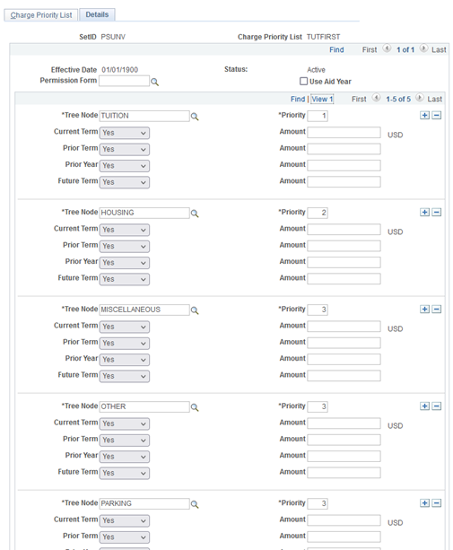

Access the Charge Priority List - Details page (Set Up SACR > Product Related > Student Financials > Charges and Payments > Charge Priority List > Details).
This example illustrates the fields and controls on the Charge Priority List - Details page. You can find definitions for the fields and controls later on this page.

Tree Node
Select allowable charges by entering the appropriate tree nodes. The system applies payments only to charge item types that fall in the range of the tree node.
Warning! You must not specify a parent and child node on a charge priority list. Doing this may cause unusual payment application issues because a charge will be selected twice: one from the parent and another from the child.
When you try to specify a parent and child node on a charge priority list, a message appears and tells you the charge priority list cannot be saved because of overlapping nodes. The message only appears for current and future-dated rows.

Priority
Assign a priority level for each tree node that is used to define allowable charges. The system uses this priority value only when you select Charge Tree Node as one of the Sort Payment Field values in your Payment Overall Priority setup. A priority of 1 is higher than a priority of 2.
Current Term
Select a value to control whether payments can be applied to charges for the current term. Four values are available for this field:
  • Yes: Select this value if you want the system to apply payments with no restrictions to charges in this time period.
  • No: Select this value if you do not want the system to apply payments to any charges in this time period.
  • Negative Permission: Select this value if you want the system to apply payments as necessary to charges in this time period, unless the student expressly prevents it. Student permissions can be used in conjunction with negative permission.
  • Positive Permission: Select this value if you want the system to require specific permission before applying payments to charges in this time period. Student permissions can be used in conjunction with permission needed.
Note: The definition of the Current Term value is determined by the value of the payment term. If no term is specified, the value of the payment term is determined by the Default Term Control value in the SF Business Unit component. Three options are available for default term control: Use SF Default Term, Use Last Enrollment Term, and Use Current Enrollment Term. When you use SF Default Term, the value of the payment term is the same as that of the SF default term. If you use either Last Enrollment Term or Current Enrollment Term as the default term control, the value of the payment term varies by the enrollment history of the student against whose account the payment is being applied.
Prior Term
Select a value to control whether and how payments can be applied to charges for the prior term. The four values for this field are the same as those defined for the Current Term field.
The prior term is the academic term that immediately precedes the current term. The actual determination of the prior term is based on the value that is used for the current term. Values are:
Use Aid Year OFF: All terms prior to the current term within the academic year only.
Use Aid Year ON: All terms prior to the current term that are in the Aid Year immediately prior to the current Aid Year, regardless of Academic Career.
Prior Year
Select a value to control whether and how payments are applied to charges for the prior year. The four values for this field are the same as those defined for the Current Term field.
Use Aid Year OFF:All terms prior to the current academic year.
Use Aid Year ON: All terms prior to the current term within the current Aid Year only, regardless of Academic Career.
Future Term
Select a value to control whether and how payments can be applied to charges for any future terms. The four values for this field are the same as those defined for the Current Term field.
A future term is an academic term that comes after the current term. The actual determination of a future term is based on the value that is used for the current term.
Use Aid Year flag OFF: A future term is an academic term that comes after the current term. The actual determination of a future term is based on the value that is used for current term.
Use Aid Year flag ON: All terms after the current term within the current aid year.
Amount
Enter the maximum amount that can be applied to the corresponding period. If no limitation exists for this payment, leave the amount field blank on all platforms except for DB2. If the amount is left blank on a DB2 platform, it functions as if it is zero and does not allow any amounts to be paid by the payment. On DB2 platforms only, you must complete the amount field with all 9s (a value of 999,999,999.00) to allow for no limitation. The field is formatted for 12.2 number entries.

In the previous section on setting up a charge priority list, the setup example shown selects charges using four Item Type Tree nodes (Tuition, Housing, Miscellaneous, and Parking) and allows payments to be applied in all time periods. Using this rule set, the system selects all of the charges on the student's account as eligible, with the exception of the phone charge.
Selected and Sorted Charges—Scenario One
Using the Payment Overall Priority setup shown previously (eligible charges sorted first by due date, then by charge tree node), the system sorts the eligible charges in this way:

In this example, all charges with due dates through 10/5/00 are paid in full and 1,725.00 USD is applied to the Spring, 2001 Tuition charge due 1/15/01. Because not enough money exists to pay all charges in full, the system applies the payment to the charges in order of the due date.
Also, note that two charges are due 10/5/00 and also two are due on 2/5/01. The system sorted these charges in order of their charge tree node priority. Recall that in the charge priority setup, the Tuition node is given a priority of 1, Housing a priority of 2, and Miscellaneous and Parking a priority of 3.

The system pays in full all Tuition charges and those Housing charges through the October 5, 2000 due date. This is because the system sorts charges first by charge tree node and second by the charge due date.
In summary, your Payment Overall Priority definition determines how the system sorts eligible charges (selected by your corresponding charge priority definition) to allocate payment.
