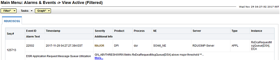

- Examine the alarm
log from
Main
Menu > Alarms & Events on the active SOAM server.
- This alarm should not normally occur when no other congestion alarms are asserted.
- Examine the alarm
log from
Main
