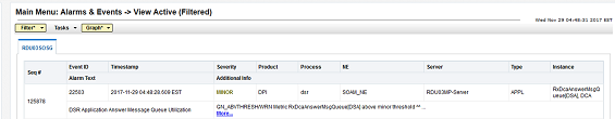

- Examine the alarm
log from
Main
Menu > Alarms & Events on the active SOAM server.

- Examine the alarm
log from
Main
