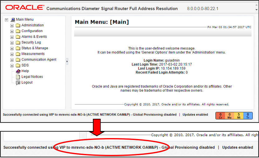

    The Product Main Menu appears.
  3. Verify that the message shown across the bottom of the panel indicates that the browser is using the VIP to connect to the ACTIVE NETWORK OAM&P.

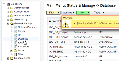

  4. Go to Main Menu, and then Status & Manage. Then, select Database.
    Figure 4-12 Main Menu - Database

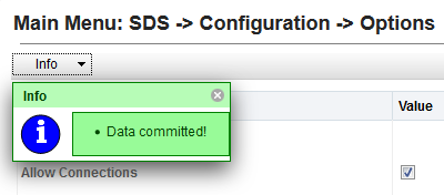

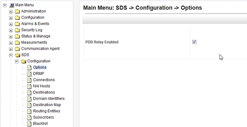

  7. To enable PDB Relay, go to Main Menu, then Configurations, and then Options. Then, check the PDB Relay Enabled option box.
    PDB Relay Enabled
    Click Apply.
    Apply
    The following confirmation message is displayed.
    Confirmation Message
