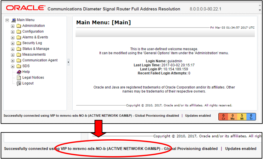

    The Product Main Menu appears.
  4. Verify that the message shown across the bottom of the panel indicates that the browser is using the VIP to connect to the ACTIVE NETWORK OAM&P.
    Figure 5-2 Product Main Menu
    Product Main Menu

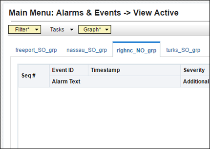

  5. Go to Main Menu, and then Alarm & Events. Then, select View Active.
    Figure 5-3 View Active
    View Active
    The current list of Active Alarms appears.
    Figure 5-4 Active Alarms
    Active Alarms

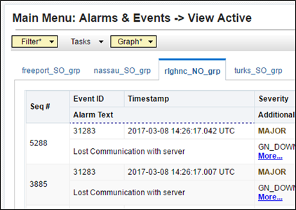

    Alarms visible at this time may include but are not limited to Event ID(s): 31106, 31107, 31114, 31233 & 31283.
  6. Monitor the current list of Active alarms until all alarms associated with the Failover have cleared.
    View Active
    The user should allow at least 15 minutes for resulting alarms to clear before attempting any troubleshooting activities.
  • Contact My Oracle Support (MOS) for assistance with any reoccurring alarms or alarms which fail to clear within a 15 minute timeframe.
  • Refer to My Oracle Support (MOS), for more information on contacting Oracle Customer Service.
