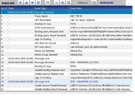

The metadata captured by IDIH for the PCA includes the results of each query that PCA makes to the session and binding database and the associated result. Whenever the result of a database query is captured in PCA metadata, it will include the identity of the specific server that generated the response.
The key concepts for PCA as it relates to IDIH are:
  • IDIH can display traces in multiple formats (for example, two- or three-way split screen or single screen). Because it is very difficult to display all of the information in a single screen, output columns slide out of view. Sliders allow the column views to be manipulated.
  • There are two basic ways to view Event and metadata information:
    • A graphical display (for example, ladder and object)
    • An event list, which provides a listing of events

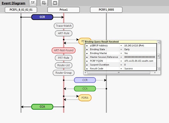

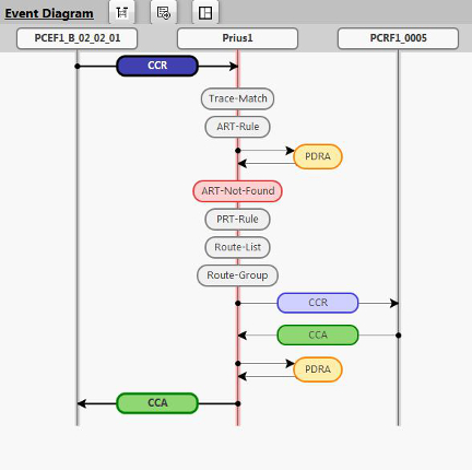

    In graphical display mode, click on the bubble to view decode information for messages. To see metadata information, hover over it (for example, the PDRA bubble), and then use the slider to move up or down to see the information linked to that event. In event list mode, select the message or slide to the right to view the event/metadata information.
The examples illustrate the type and format of information that is collected and used from Policy DRA IDIH traces.
Although these examples are for Policy DRA, information collected and used from Online Charging DRA IDIH traces is similar in presentation.
Figure 2-21 Event Diagram Trace – CCR Example
img/event_diagram_ccr_exchange.jpg
Figure 2-22 Update Request Policy DRA Example
img/update_request_pdra_metadata_example.jpg
Figure 2-23 Event Diagram – Hover (Mouse-over) Example
img/mouseover_display_eventdiagram.jpg
