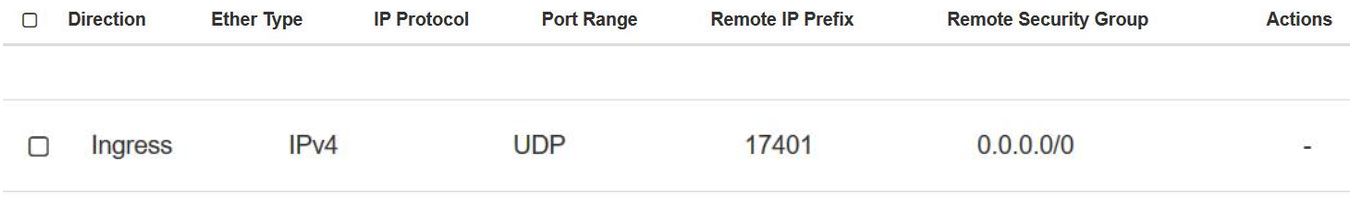

  2. If ping request or response packets are not coming from any server, then add security group rule ingress (response) or egress (request) to that instance.
    The following image shows Ingress response:
    Figure 22-1 Ingress Response
    Ingress Response
  3. Check the ping packets again after adding the rule and ensure that imi request and response packets are received from each servers, by executing:
    tcpdump -i eth1 -n "<server-A>-imi or <server-B>-imi and port 17401 and udp"
