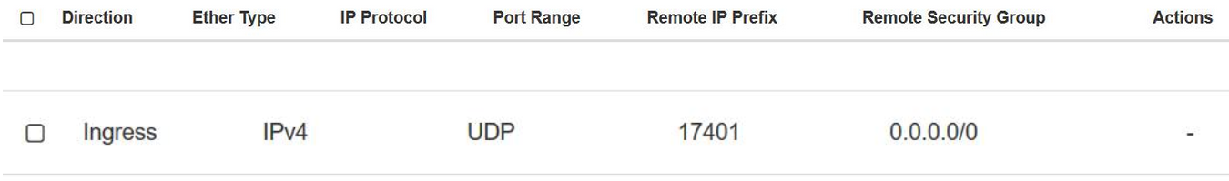

21.4 Resolve HA Alarms on VNF through VNFM Deployed Setup
Perform the following to resolve the HA alarms:
- Check the ping request and
response packets from Server-A and Server-B for which alarm has been raised, by
executing:
tcpdump -i eth1 -n "host <server-A>-imi or <server-B>-imi and port 17401 and udp"
For example:
tcpdump -i eth1 -n "host noam00-17badf67-imi or noam01-17badf67-imi and port 17401 and udp"
- If ping request or response packets are not coming
from any server, then add security group rule ingress (response) or egress (request)
to that instance.
The following image shows Ingress response:
Figure 21-1 Ingress Response
- Check the ping packets again
after adding the rule and ensure that
imi
request and response packets are received from each servers, by executing:tcpdump -i eth1 -n "<server-A>-imi or <server-B>-imi and port 17401 and udp"
- Now restart the cmha process
on the node where the alarms are present, by executing:
pm.set off cmha && sleep 5 && pm.set on cmha
If the Node is HA Active, then restarting cmha will cause switch over.

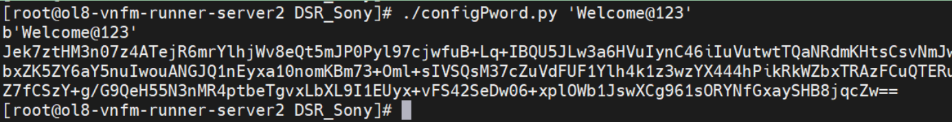

21.11 Changing VNF CLI and DSR GUI Log in Credentials
This section provides information to change VNF CLI and DSR GUI log in username and password.
Prerequisites
- The new credentials are supported by the DSR Image.
- The updated username must be a plain text.
- The updated password must be encrypted using the utility function which
is
/configPword.py'passwordToBeEncrypted'
.Following is an example showing the usage of the script:
Figure 21-2 Usage of Script
- The encrypted password must be updated in
VnfmPropeties.yaml
file.
Procedure
In the 'dsrvnfm' user mode:
- Open VnfmProperties file -
/opt/vnfm/config/VnfmProperties.yaml
to edit the properties. - To change VNF CLI log in username and password, update
admUsrUsername
andadmUsrPword
fields. - To change the DSR GUI username and password, update
dsrNoamUsername
anddsrNoamPword
fields.
