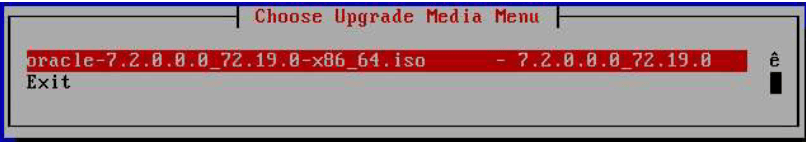

3.5.5.2.1.5 IDIH CLI: Start Oracle Guest Upgrade
Following are the steps to upgrade the Oracle Guest using the Platform Configuration utility:
  1. Launch the Platform Configuration utility by running the following command:
    $ sudo su - platcfg
  2. In the Resulting menu, navigate to Maintenance, select Upgrade, and then click Initiate Upgrade.
  3. At the ISO selection menu, select the target release Oracle ISO and click Enter to launch Platform Configuration utility.
    Figure 3-3 Upgrade Media Menu
    Upgrade Media Menu
