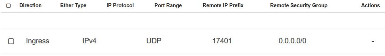

- If ping request or response packets are not coming
from any server, then add security group rule ingress (response) or egress (request)
to that instance.
The following image shows Ingress response:
Figure 22-1 Ingress Response
