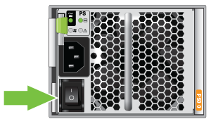

  3. Make sure that the circuit breakers located on the rear left and right side power supplies of the Oracle ZFS Storage Appliance ZS5-ES are in the ON (|) position.
    Figure 5.4 Oracle ZFS Storage Appliance ZS5-ES Circuit Breakers

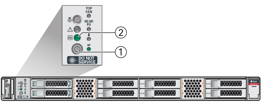

  4. Press the Power button located on the front of the first (bottom) management node. See Figure 5.5.
    The first management node is located in rack unit 5 (U5). The second management node is located in rack unit 6 (U6). It is switched on and configured automatically during the initial power-on sequence.
    A management nodes take approximately five to ten minutes to power on completely. Once complete, the Power/OK LED illuminates and remains a steady green.
    Figure 5.5 Oracle Private Cloud Appliance Management Node
    This figure shows the location of the Power/OK LED and Power button on the Oracle Private Cloud Appliance management node.
    Table 5.2 Figure Legend
    Item
    Description
    1
    Power button
    2
    Power/OK LED
