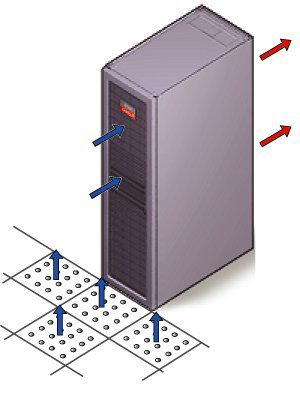

Use perforated tiles, approximately 400 CFM/tile, in front of the rack for cold air intake. The tiles can be arranged in any order in front of the rack, as long as cold air from the tiles can flow into the rack. Inadequate cold airflow could result in a higher intake temperature in the system due to exhaust air recirculation. The following is the recommended number of floor tiles:
Four floor tiles for an Oracle Private Cloud Appliance with up to 25 compute nodes (fully loaded)
Three floor tiles for an Oracle Private Cloud Appliance with up to 16 compute nodes (half loaded)
One floor tile for an Oracle Private Cloud Appliance with 8 compute nodes (quarter loaded)
Figure 2.1 shows a typical installation of the floor tiles in a data center for Oracle Private Cloud Appliance with more than 16 compute nodes.
