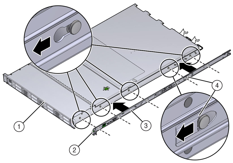

Position a mounting bracket against the chassis so that the slide-rail lock is at the server front, and the five keyhole openings on the mounting bracket are aligned with the five locating pins on the side of the chassis. See Figure 6.3.
Figure 6.3 Aligning the Mounting Bracket With the Server Chassis
Table 6.3 Figure LegendItem
Description
1
Chassis front
2
Slide-rail lock
3
Mounting bracket
4
Mounting bracket clip
With the heads of the five chassis locating pins protruding through the five keyhole openings in the mounting bracket, pull the mounting bracket toward the front of the chassis until the mounting bracket clip locks into place with an audible click.
Verify that the rear locating pin has engaged the mounting bracket clip.
Repeat these steps to install the remaining mounting bracket on the other side of the server.

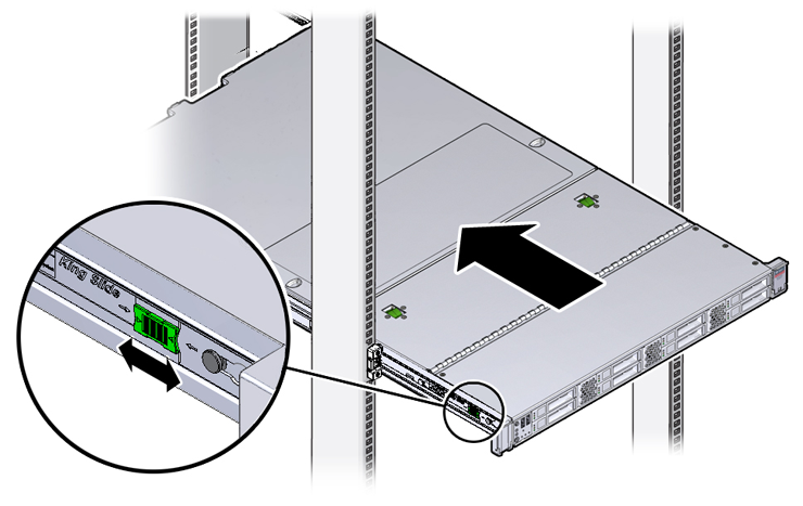

Simultaneously push and hold the green slide-rail release buttons on each mounting bracket while you push the server into the rack. Continue pushing the server into the rack until the slide-rail locks (on the front of the mounting brackets) engage the slide-rail assemblies. See Figure 6.7.
You will hear an audible click.
Figure 6.7 Sliding the Server Into the Rack

NoteTo pull the green release tabs, place your finger in the center of each tab, not on the end, and apply pressure as you pull the tab toward the front of the server.
Figure 6.13 Location of the Slide-Rail Release Tabs
Continue pushing the server into the rack until the slide-rail locks (on the front of the server) engage the slide-rail assemblies.
You will hear an audible click when the server is in the normal rack position.
