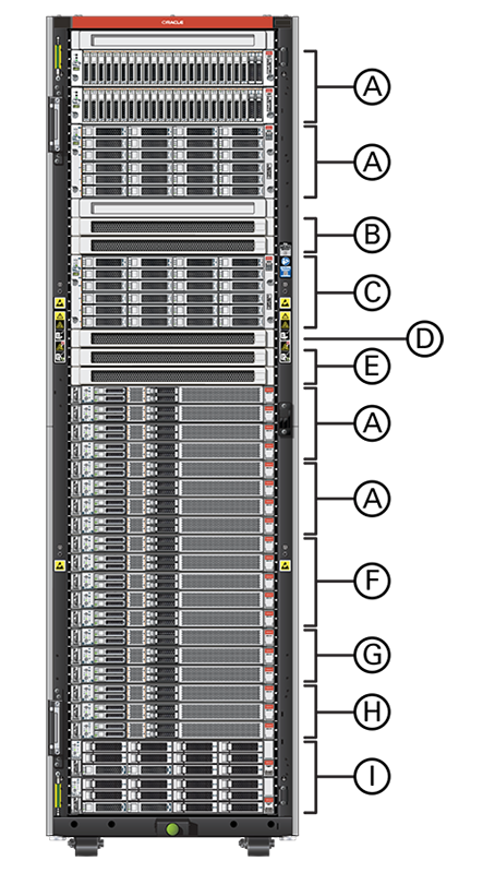

This chapter provides an overview of the hardware components that the Oracle Private Cloud Appliance comprises: a base rack with servers, switches and storage. Different sections describe the role of each component. Special attention is given to the appliance network infrastructure, and the way it integrates with the data center environment and, optionally, an Oracle Exadata system.
Base Rack Components
The current Private Cloud Appliance hardware platform, with factory-installed software release 3.0.1, consists of an Oracle Rack Cabinet 1242 base, populated with the hardware components identified in the figure below. This figure shows a full configuration, however you can customize your system to include different storage or compute capacity as needed.
Starting with release 3.0.1, the flex bay concept is available on Private Cloud Appliance. Flex bays are dedicated 4 rack unit sections within the rack that can be used for flexible expansion of your system; adding either storage or compute resources. For each flex bay, you can choose to add 1-4 compute nodes, 1 Oracle Storage Drive Enclosure DE3-24C, or 1-2 Oracle Storage Drive Enclosure DE3-24P. A flex bay can house either storage or compute resources, but not both in the same bay.
Figure Legend
| Callout | Quantity | Description |
A |
1 - 4 |
flex bay can accommodate 1-4 compute nodes, or 1-2 storage enclosures |
B |
2 |
leaf switch |
C |
1 |
Oracle Storage Drive Enclosure DE3-24C disk shelf |
D |
1 |
management switch |
E |
2 |
spine switch |
F |
1 - 5 |
can accommodate 1 - 5 compute nodes |
G |
3 |
compute nodes 3 required for minimum configuration |
H |
3 |
management nodes |
I |
2 |
storage controllers |

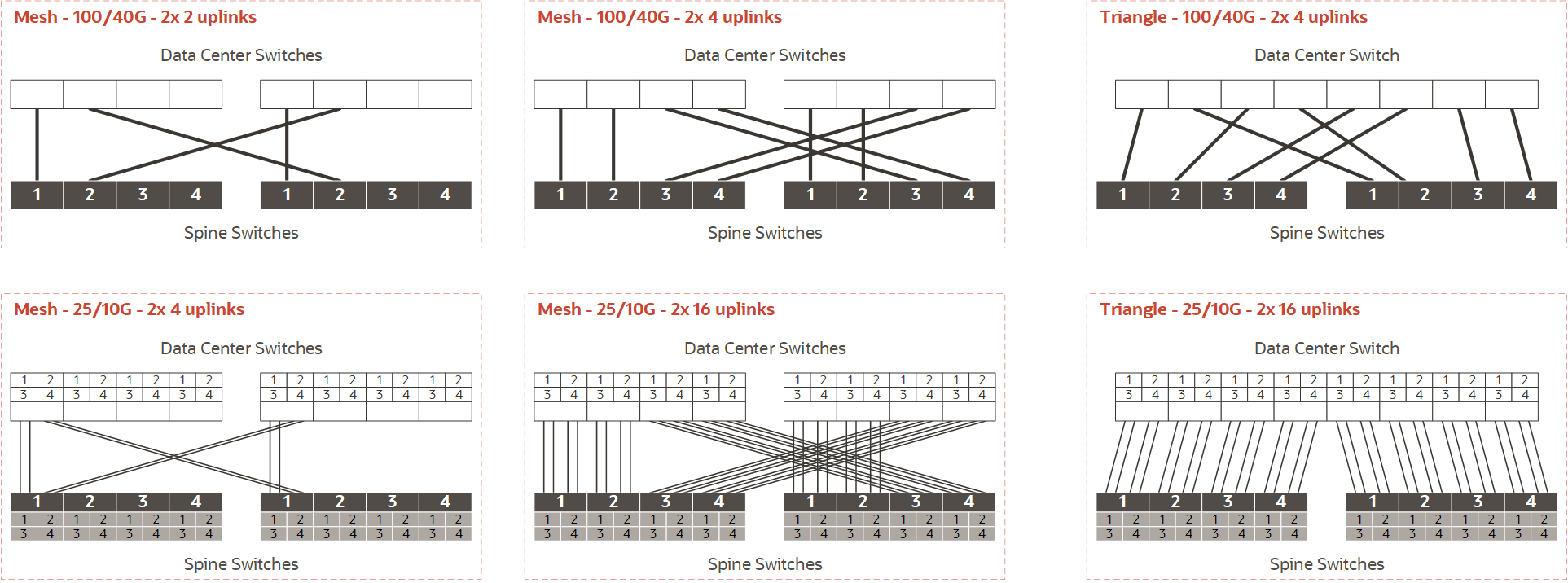

Reference Topologies
The physical topology for the uplinks from the appliance to the data center network is dependent on bandwidth requirements and available data center switches and ports. Connecting to a single data center switch implies that you select a triangle topology. To increase redundancy you distribute the uplinks across a pair of data center switches, selecting either a square or mesh topology. Each topology allows you to start with a minimum bandwidth, which you can scale up with increasing need. The maximum bandwidth is 800 Gbps, assuming the data center switches, transceivers and cables allow it.
The diagrams below represent a subset of the supported topologies, and can be used as a reference to integrate the appliance into the data center network. Use the diagrams and the notes to determine the appropriate cabling and switch configuration for your installation.
Diagram Notes
On the appliance side there are two spine switches that must be connected to the data center network. Both spine switches must have identical port and cable configurations. In each example, the spine switches are shown at the bottom, with all uplink ports identified by their port number. The lines represent outgoing cable connection to the data center switches, which are shown at the top of each example without port numbers.
Cabling Pattern and Port Speed
There are six examples in total, organized in two rows by three columns.
The top row shows cabling options based on full-port 100Gbps or 40Gbps connections. The bottom row shows cabling options using breakout ports at 25Gbps or 10Gbps speeds; the smaller boxes numbered 1-4 represent the breakout connections for each of the four main uplink ports per spine switch.
The third column shows a triangle topology with full-port connections and breakout connections. The difference with column two is that all uplinks are connected to a single data center switch. The total bandwidth is the same, but the triangle topology lacks data center switch redundancy.
There are no diagrams for the square topology. The square cabling configuration is like the mesh examples, but without the crossing patterns. Visually, all connectors in the diagrams would be parallel. In a square topology, all outgoing cables from one spine switch are connected port for port to the same data center switch. Unlike mesh, square implies that each spine switch is peered with only one data center switch.
Link Count
When connecting the uplinks, you are required to follow the spine switch port numbering. Remember that both spine switches are cabled identically, so each uplink or connection corresponds with a pair of cables.
With one cable per spine port, using 100 or 40 Gbps transceivers, the first uplink pair uses spine switch ports numbered "1", the second uses port 2, and so on. In this configuration, the maximum number of uplinks is four per spine switch.
When breakout cables are used, with 25 or 10Gbps port speeds, the first uplink pair uses port 1/1. With two or four uplinks per spine switch there is still only one full port in use. When you increase the uplink count to 8 per spine switch, ports 1/1-2/4 are in use. At 16 uplinks per spine switch, all breakout connections of all four reserved ports will be in use.
In a mesh topology, a particular cabling pattern must be followed: connect the first half of all uplinks to one data center switch, and the second half to the other data center switch. For example: if you have four uplinks then the first two go to the same switch; if you have eight uplinks (not shown in the diagrams) then the first four go to the same switch; if you have 16 uplinks then the first eight go to the same switch.
Mesh Topology Implications
In a mesh topology, the spine switch configuration expects that the first half of all uplinks is connected to one data center switch, and the second half to the other data center switch. When you initially connect the appliance to your data center network, it is straightforward to follow this pattern.
However, if you increase the number of uplinks at a later time, the mesh cabling pattern has a significant implication for the existing uplinks. Compare the diagrams in the first two columns: when you double the uplink count, half of the existing connections must be moved to the other data center switch. For 100/40Gbit uplinks, re-cabling is only required when you increase the link count from 2 to 4. Due to the larger number of cables, 25/10Gbit uplinks require more re-cabling: when increasing uplink count from 2 to 4, from 4 to 8, and from 8 to 16.
