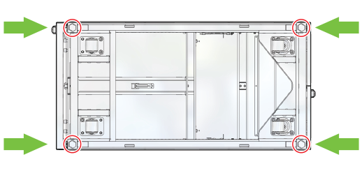

                           Locate the four leveling feet at the bottom four corners of the rack. Figure 4-3 Location of Leveling Feet on Rack

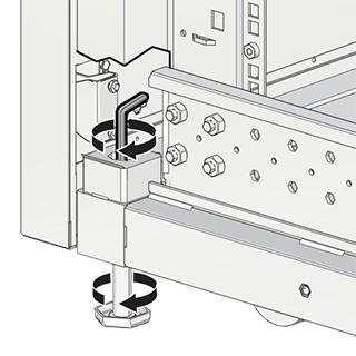

                           Using a 6mm hex wrench, lower the leveling feet to the floor. Figure 4-4 Lowering the Leveling Feet

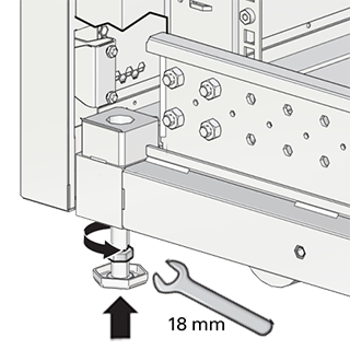

                           Lock the four leveling feet using an 18mm open wrench. Figure 4-5 Locking the Leveling Feet  When lowered correctly, the four leveling feet share the load with the casters to increase footprint, improve stability, and help support the full weight of the Oracle Private Cloud Appliance.

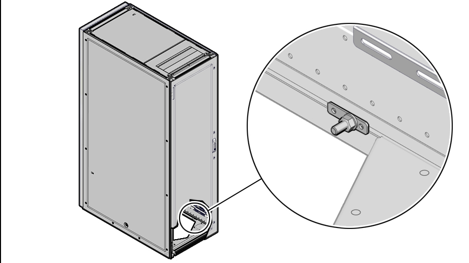

                           Attach the ground cable to one of the attachment points located at the bottom rear of the system frame. See Figure 4-6. The attachment point is an adjustable bolt that is inside the rear of the system cabinet on the right side. Figure 4-6 Earth Ground Attachment Bolt Location
