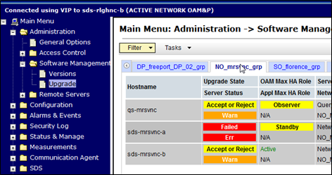

  1. Access the primary SDS NOAM GUI, use the VIP address to access the primary SDS NOAM GUI as described in Access the OAM GUI Using the VIP (NOAM/SOAM).
  2. In the primary SDS NOAM VIP, verify upgrade state.
    1. Expand Administration navigate to Software Management click Upgrade.
    2. Verify the host name of the primary active SDS NOAM server from the GUI banner.
    3. Select the Server Group tab for the server(s) being upgraded.
    4. Verify the Upgrade State for each server undergoing the software upgrade and identify any servers with a Failed state.
    Figure 17-1 Server State
    Server State
    If the Failed Server was upgraded using the Auto Upgrade option, that is, Auto Server Group Upgrade, then continue to the next step of this procedure. If the Failed Server was upgraded using the Upgrade Server option, then skip to step 11 of this procedure.

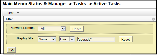

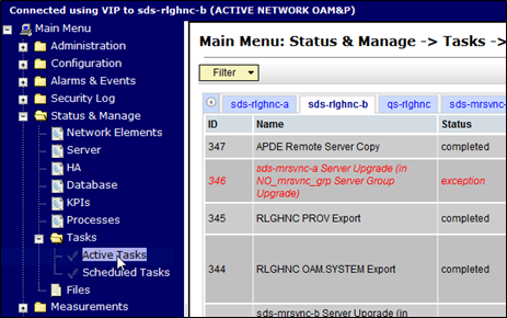

  3. In the Primary SDS NOAM VIP, filter the servers that need upgrading. Expand Status & Manage navigate to Tasks click Active Tasks.
    Figure 17-2 Active Tasks
    Active Tasks
  4. From the Filter option, enter the following filter values:
    1. Network Element: All
    2. Display Filter: Name Like *upgrade*
  5. Click Go

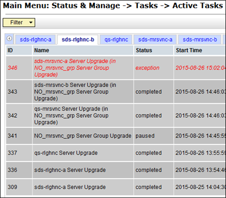

  6. In the primary SDS NOAM VIP, locate the Server Group Upgrade task. If not already selected, select the tab displaying the host name of the active SDS NOAM server. Locate the task for the Server Group Upgrade. It shows a status of paused.
    Figure 17-4 Server Group Upgrade
    Consider the case of an upgrade cycle where it is seen that the upgrade of one or more servers in the server group has the status as exception (that is, failed), while the other servers in that server group have upgraded successfully. However, the server group upgrade task still shows as running. In this case, cancel the running (upgrade) task for that server group before reattempting ASU for the same.
    Before clicking Cancel for the server group upgrade task, ensure the upgrade status of the individual servers in that particular server group have status as completed or exception (that is, failed for some reason). Make sure you are not canceling a task with some servers still in running state.

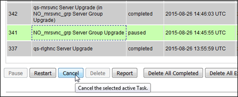

  7. In the primary SDS NOAM VIP, cancel the Server group Upgrade task.
    1. Click the Server Group Upgrade task to select it.
    2. Click Cancel to cancel the task.
    Figure 17-5 Cancel Task
    Cancel Task

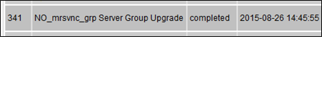

  9. In the primary SDS NOAM VIP, verify if the Server Group Upgrade task is canceled. On the Active Tasks screen, verify the Status changed from paused to completed.
    Figure 17-7 Status
    Status

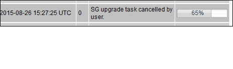

  10. Verify the Result Details column now states “SG upgrade task canceled by user.
    Figure 17-8 SG upgrade task cancelled
