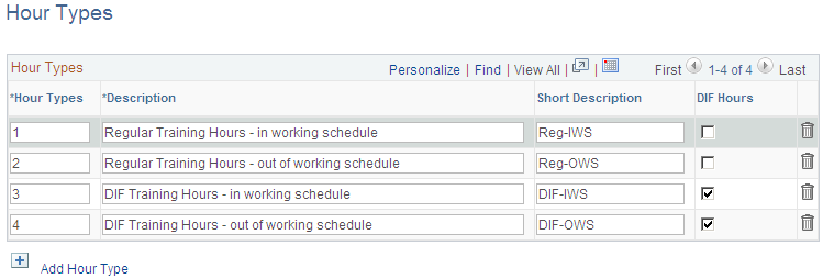

For example, assume that a DIF-eligible class has one session component with a duration of five hours. The learner spends one hour during the normal work schedule at the training session and four hours outside the work schedule. After the learner completes the training, the administrator uses the roster to associate hours types with the learner's hours as follows:
Hour Type |
Number of Hours |
DIF Training Hours - in working schedule |
1 |
DIF Training Hours - out of working schedule |
4 |

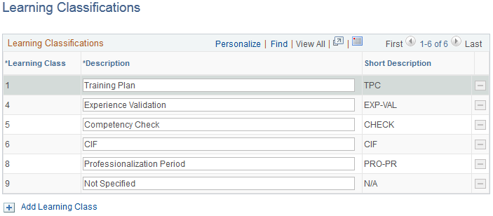

Under French law, training must be categorized according to a specific set of learning classifications, such as competency check, CIF (Congé Individuel de Formation) and experience validation. These classifications appear on training reports, and can affect a learner's compensation for training time. Enterprise Learning Management delivers the valid classifications that are required by French law. You can modify the classification descriptions, but you should not modify their numerical identifiers. Changing the numeric codes can compromise the integrity of the data used in the 2483 report.

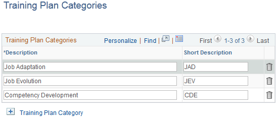

French law also requires that training plan categories be assigned to enrollments when producing training plans. Enterprise Learning Management delivers the valid Training Plan Categories required by French law. As with learning classifications, you can modify the classification descriptions, but you should not modify the numerical identifiers as changes can compromise the integrity of the data used in the 2483 report.
Review the delivered hour types and modify if necessary.
Administrators use hour types to designate for a learner, when training occurred—that is, how many hours occurred during or outside of the learner's regular work schedule—and whether any of the hours were related to DIF. Enterprise Learning Management delivers four hour types. You can modify the descriptions of the delivered hour types but should not update their numerical identifiers.

Use the Learning Classifications page (LM_TRAINING_CLASS) to review delivered learning classifications.
Navigation:
This example illustrates the fields and controls on the Learning Classifications page.
Some of the classifications can be used within the 2483 report.
Warning! Six learning classifications are delivered as system data with Enterprise Learning Management. You can modify their descriptions, but the corresponding numerical codes are not editable.
Use the Training Plan Categories page (LM_TRG_PLN_CTG) to review delivered training plan categories.
Navigation:
This example illustrates the fields and controls on the Training Plan Categories page.
Warning! Three learning classifications are delivered as system data with Enterprise Learning Management. You can modify the descriptions, but should not change the corresponding numerical codes. Modifying the codes can compromise the integrity of the statistical data that is reported in training plans and the 2483 report.
Use the Hour Types page (LM_HOUR_TYPE) to review and define hour types.
Navigation:
This example illustrates the fields and controls on the Hour Types page.
Warning! Four hour types are delivered as system data with Enterprise Learning Management. You can modify the descriptions, but should not change the numerical classification codes. Modifying the codes can compromise the integrity of data that is reported in training plans and the 2483 report.
You can add hour types, however no system logic is tied to new hour types and they will not be exported to HR.

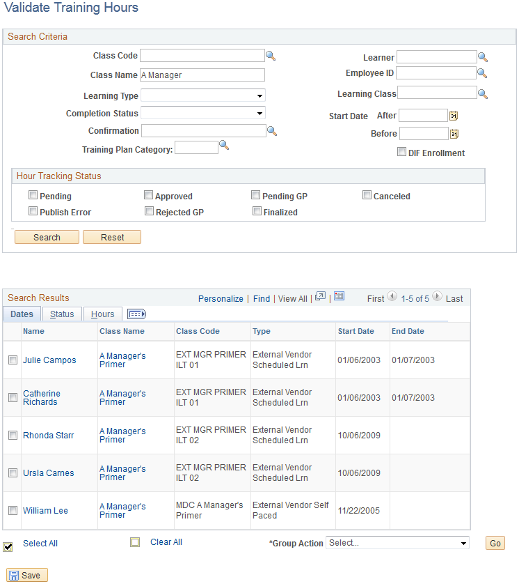

Use the Validate Training Hours page (LM_TRK_HRS_SRCH) to validate training hours and review the status of hours sent to the Administer Training business process.
Navigation:
This example illustrates the fields and controls on the Validate Training Hours page.
Administrators can validate hours for classes within their own learning environment.
To review and validate training hours:
Enter the search criteria to locate the enrollment records you want to review.
In the search results, the Hours tab shows the validation status (for example, whether the hours are pending review or have already been sent to HR) and a breakout of the learner's hours by hour type. Administrators specify the number of hours by hour type on the Component Duration page (LM_LRNR_ROSDUR_SEC) of the class roster.
Update a learner's hour tracking status or use the Group Action feature to change the status of multiple learners simultaneously.
When using the Group Action feature, you can change the status to Approved by ELM Administrator, Canceled, or Pending Review from ELM Administrator.
Search Criteria
Use the following fields to search for the training you want to validate.
Field or Control |
Description |
Class Code |
Enter a class code. |
Class Name |
Enter a class name. Note: This field is case sensitive. |
Learner |
Enter a learner's name. |
Employee ID |
Enter an employee's unique ID. |
Type |
Select a delivery method. |
Completion Status |
Select a completion status. |
DIF Enrollment |
Select to retrieve records for DIF enrollments only. |
Learning Class (learning classification) |
To search for enrollment records associated with a particular learning classification, select the classification here. |
Training Plan Category |
To search for enrollment records associated with a particular training plan category, select the classification here. |
Start Date |
To search for enrollment records for classes that began within a certain date range, enter the class start dates here. The process goes through all components of a class. A status is managed at the learning component level so a component is not sent twice to HR. So even though a user cannot select a component to publish, the process knows which components to publish, based on the status field. |
Hour Tracking Status
Select the tracking status of enrollment records you want to review. For example, select Pending to see the records that require validation; select Approved to see the records that have been validated and are ready for export.
Dates Tab
This tab displays the class name, code, type, start date, and end date.
Status Tab
The Status tab shows the learning classification, training plan category, the completion status, and a DIF check box that is selected if hours for the class are to be applied to DIF. Learners can request the use of DIF hours on the self-service page during enrollment; administrators can indicate that DIF hours are to be used on the Learner Roster page that is accessible through the class roster.
Hours Tab

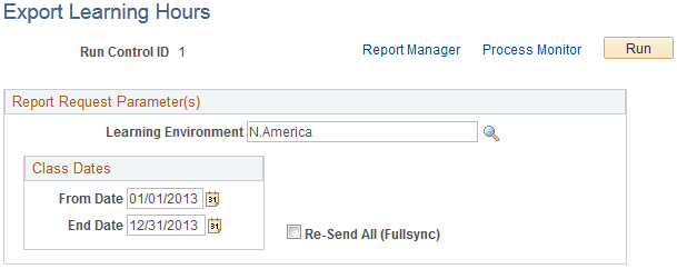

Use the Export Learning Hours page (LM_RUNCTL_LEFR002) to publish learning hours to the Administer Training business process.
Navigation:
This example illustrates the fields and controls on the Export Learning Hours page.
The LM_STD_HOUR Application Engine process uses an asynchronous XML message (TRAINING_HOUR) to publish validated training hours to HR. You can set up the process to run at regular intervals, such as daily or weekly. You can also run the process on an as-needed basis.
For affected learners, the message publishes information about the class, learning component, session start and end date, session duration, and the number of hours associated with each hour type. When you run the process, only those hours that have an hour tracking status of Approved by ELM Administrator are published. As soon as the hours are published, their status changes to Pending Review from Payroll. You cannot modify or resubmit these hours unless the payroll administrator rejects the hours, which sets the status to Rejected by Payroll Admin.
Upon receipt of the message, a HR administrator validates the training hours and sends the approved information to Global Payroll for processing.
After you publish training hours, use the Validate Training Hours page to search for enrollment records with a status of Rejected by GP or Publish Error.
Field or Control |
Description |
Learning Environment |
Select the learning environment of the classes for which you want to publish hours. |
From Date and End Date |
To publish hours for only those classes that started and ended within a given date range, enter the dates here. The system will publish the hours for the components of those classes that started on or after the specified From Date and that ended on or before the End Date. If no dates are entered, the process sends hours for all classes that are associated with the selected learning environment and that have a status of Approved by ELM Administrator. |
Re-Send All (Fullsync) |
Select to publish all hours that meet the selection parameters again, not just those that have never been published. Note: When you select this option, the system uses the full sync EIP message to publish hours to HR. This EIP can generate a high volume of data and should be used only if you need to resynchronize HR and Enterprise Learning Management data. |

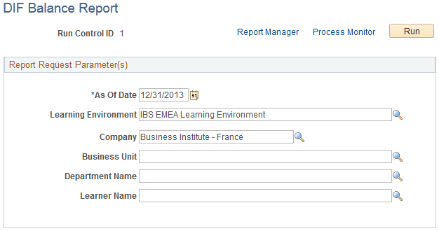

Use the DIF Balance Report page (LM_RUNCTL_DIF) to report DIF balances.
Navigation:
This example illustrates the fields and controls on the DIF Balance Report page.
Use this page to generate a report listing DIF balances for a configurable subset of employees.
Field or Control |
Description |
As Of Date |
The report lists DIF balances as of the date you enter in this field. |
Enter a value to filter the employees included in the report by learning environment. |
Company |
Enter a value to filter the employees included in the report by company. |
Business Unit |
Enter a value to filter the employees included in the report by business unit. |
Department Name |
Enter a value to filter the employees included in the report by department. |
Learner Name |
Enter a value to generate a DIF balance report for a specific employee. |
