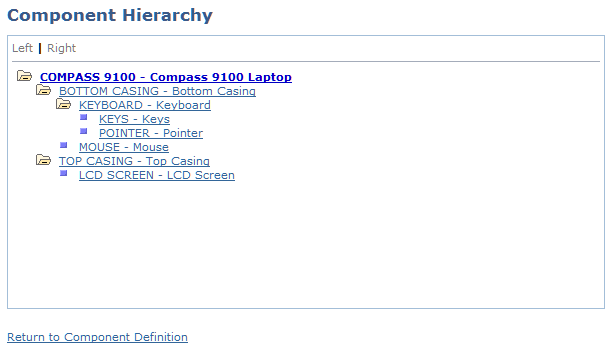

For example, here is a simple breakdown of a laptop computer's components:
This example illustrates the fields and controls on the Example of laptop component hierarchy.
At the least, a laptop computer is made up of a bottom casing and a top casing. One of the bottom casing's subcomponents is the keyboard, which is made up of several individual keys. The top casing has a liquid crystal display (LCD) screen as one of the subcomponents. As you can see, this breakdown could go on for many levels.
Suppose that you manufacture laptops, and you want to offer an improved LCD screen. The laptops that include the improved screen are a new version. As you create the version's component definition, the only change is the LCD screen, but that change means that the hierarchy of components is different. By attaching the new component definition to a new and unique component version, you are assured that the correct LCD screen is available as you drill down on the product components.

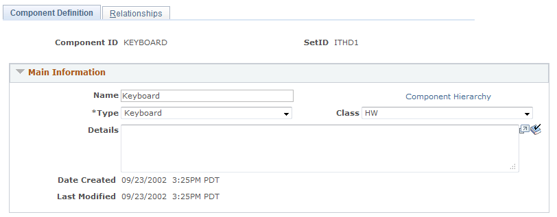

Use the Component Definition page (RQ_COMP_DEFN) to define product components.
Navigation:
This example illustrates the fields and controls on the Component Definition page.
The component definition is a more specific description of a particular component. For example, you might have a laptop keyboard with gray keys and another with black keys. The component definition enables you to distinguish between the two keyboards.
The component definitions also show the level at which subcomponents are linked to other components in a child-to-parent relationship, creating a hierarchy that culminates in the product component definition.
Field or Control |
Description |
Name |
Enter the component name. This name is informational only and can be the same as the component ID or type description. |
Component Hierarchy |
Click this link to view the hierarchy of components. |
Type |
Select the type of component that you described in the Name field. |
Class |
Select a component class description. Values are: Doc (documentation), HW (hardware), Service, Test, Third Party Doc (third-party documentation), Third Party HW (third-party hardware), Third Party SW (third-party software), and Third Party Service. |

Component relationships define the component hierarchy. In the example of the laptop computer, the bottom casing includes the keyboard assembly, which is made up of individual keys. Thus, the bottom casing is the parent to the keyboard assembly, which, in turn, is the parent to the keys.

To view the component relationship, return to the Component Definition page. Click the Component Hierarchy link to access the Component Hierarchy page. Click the Refresh button to display newly added components.

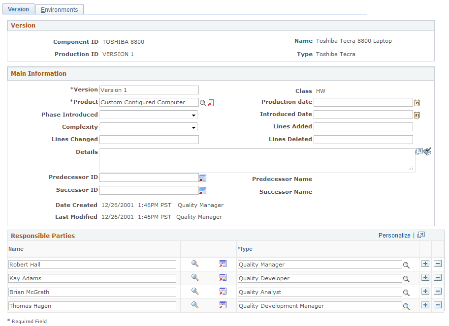

Use the Version page (RQ_PROD_VERS) to define distinct component versions.
Navigation:
This example illustrates the fields and controls on the Version page.
Products consist of components. When one or more of these components changes, you refer to the changed product as a new version. PeopleSoft Quality Management enables you to uniquely identify different product versions by defining different component versions. Each version represents a unique product component definition.
Note: When creating a new value, the Production ID is in a free form text field. The Production ID is the link between the product and the version.
Main Information
Field or Control |
Description |
Version |
Enter a word or phrase to describe the version build. |
Product |
Select the product that is associated with the component. |
Phase Introduced |
Select the product development phase in which this component version was introduced. Values are: Alpha, Analysis/Design, Beta, Concept, Implementation, Maintenance, Production, Requirements, and Retirement. |
Complexity |
Select the level of complexity that best represents what it would take to fix a defect in the component. |
Production Date and Introduced Date |
Enter the dates the product was first produced and introduced to the market. |
Lines Added, Lines Changed, and Lines Deleted |
Enter the lines of code that were added, changed, or deleted in this version. These fields apply to software code. |
Predecessor ID and Successor ID |
Enter a predecessor and successor version, if applicable. |
Responsible Parties
Generally, responsible parties are the team members charged with maintaining a product's quality and components. Responsible-party information entered here automatically transfers to the Defect page when the version is selected on that page.
Field or Control |
Description |
Name |
Select the names of responsible parties. |
Type |
Select the responsible party's role. |

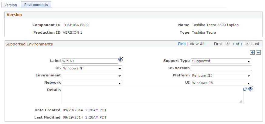

Use the Environments page (RQ_PROD_VERS_ENV) to define version environment details.
Navigation:
This example illustrates the fields and controls on the Environments page.
Component version environments relate only to software products and describe technical details needed to identify problems and fixes. Environment information entered here automatically transfers to the Defect page when the corresponding version is selected. This page is needed for software products only.
Field or Control |
Description |
Label |
Describe the component version environment. |
Support Type |
Select whether the software version has service support. |
OS (operating system) and OS Version (operating system version) |
Select the software operating system and version. |
Environment, Platform, and Network |
Select the database management system environment (for example, Microsoft SQL Server or Oracle), hardware platform, and network protocol within which the software operates. |
UI (user interface) |
Select the user interface that the software uses. |
