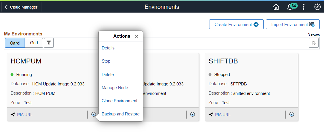

Use the Environments page (ECL_ENVPRO_FL) to access the Environments landing page. You can view the environments in card or grid (list) format. This documentation typically refers to the card format.
Navigation:
Click the Environment tile on the delivered Cloud Manager Fluid home page. The Environments page is displayed.
This example illustrates the fields and controls on the Environments page. You can find definitions for the fields and controls later on this page.
Environments page

Actions on the Environment
You can perform a variety of actions on the environment by using the Related Actions button corresponding to each environment. The actions can be:
  • Details: Select this option to view environment details and to perform additional actions on the environment such as performing a health check, applying a PeopleTools patch, viewing logs, and managing PUM connections.
  • Start: Select this option to start all the instances and then all the domains within them.
  • Stop: Select this option to stop all domains and shutdown all the instances. In case of database, only compute database instances are shutdown. You cannot stop the DB system if it is used as a database tier and has multiple PDBs.
  • Delete: Select this option to remove the environment.
    Note: If DB system is used as a database tier and has multiple PDBs, only the PDB is deleted and the DB system is not terminated.
  • Manage Node: Select this option to scale environment up or down.
  • Clone Environment: Select this option to clone an existing environment.
  • Refresh: Select this option to refresh the database or the database, Application Home (PS_APP_HOME) and Custom Home (PS_CUST_HOME).
    This option is only available for DBaaS environments. This option is disabled for environments that use DB system as database tier and have multiple PDBs.
  • Backup and Restore: Select this option to backup or restore an environment.
  • Deploy: Select this option to continue deploying an environment that has paused after infrastructure creation.
  • Delegate Access: Select this option to grant a user ID access to perform specified actions on the environment.
  • Disaster Recovery: Select this option to set up an environment as a standby in case of failure.
