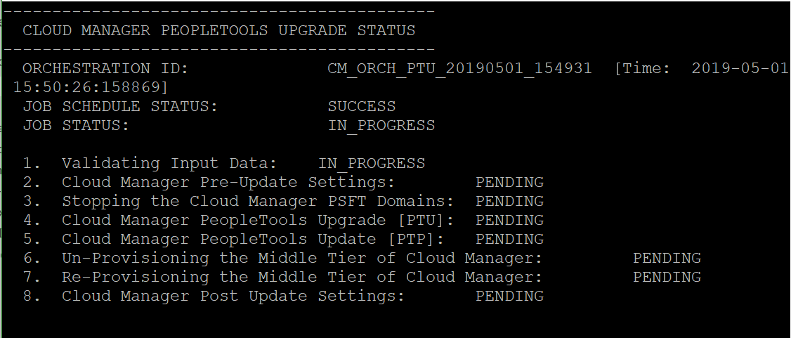

When the PeopleTools Upgrade begins, the status will show in progress and you can see what step is executing.
This example illustrates Cloud Manager PeopleTools Upgrade Status.
Cloud Manager PeopleTools Upgrade Status starting

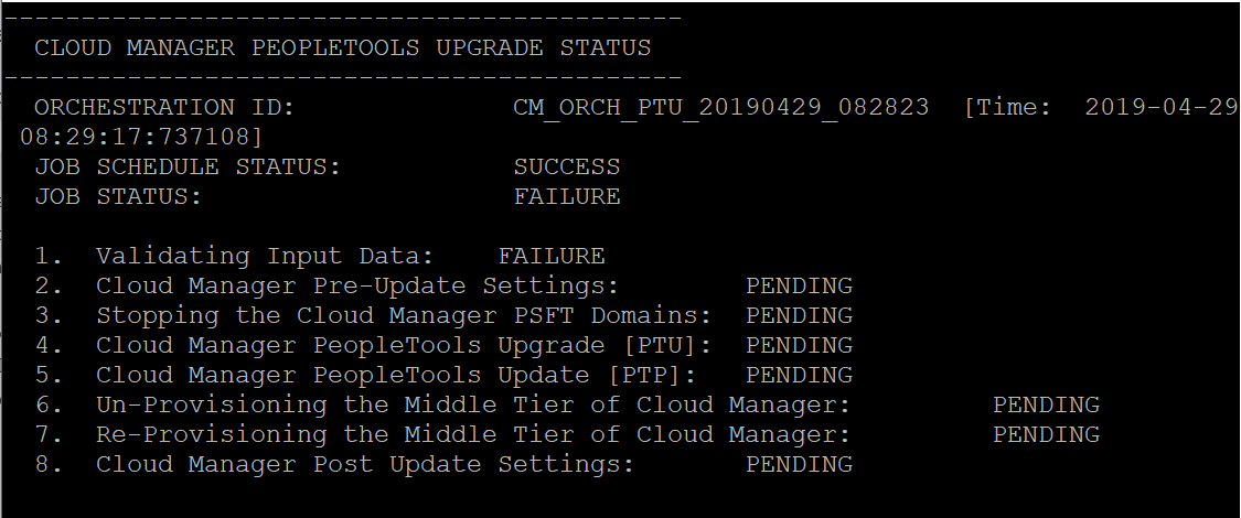

If a step fails, the status will show failure. You will need to correct the failure and either retry or mark the step as complete in order to continue.
This example illustrates Cloud Manager PeopleTools Upgrade Status where a step has failed.
Cloud Manager PeopleTools Upgrade Status with failed step

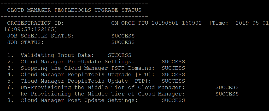

This example illustrates Cloud Manager PeopleTools Upgrade Status where all steps are successful.

      4.4  Adding Environment Info to CA:       SUCCESS
            Details: Successfully completed
      4.5  CA PTU Apply Process:        SUCCESS
  5.  Cloud Manager PeopleTools Update [PTP]:   SUCCESS
      TASK DETAILS:              Successfully completed
      TASK LOG:                 /home/psadm2/psft/data/cloud/cmlogs/envs/CLOUD_MANAGER_INSTANCE/CM_PTP_UPDATE_0_20190501_160930/out.log
      5.1  Performing PsftActivityWindowsCloudFolderSync:       SUCCESS
      5.2  Performing Windows Client Install Activity:  SUCCESS
      5.3  Adding Environment Info to CA:       SUCCESS
      5.4  CA PTP Apply Process:        SUCCESS
  6.  Un-Provisioning the Middle Tier of Cloud Manager:         SUCCESS
      TASK LOG:                 /home/psadm2/psft/data/cloud/cmlogs/envs/CLOUD_MANAGER_INSTANCE/CM_UNPROV_MT_0_20190501_160936/out.log
      6.1  Performing Unprovision MT:   SUCCESS
  7.  Re-Provisioning the Middle Tier of Cloud Manager:         SUCCESS
      TASK LOG:                 /home/psadm2/psft/data/cloud/cmlogs/envs/CLOUD_MANAGER_INSTANCE/CM_REPROV_MT_0_20190501_160942/out.log
      7.1  Performing Reprovision MT:   SUCCESS
      7.2  Cloud Manager Post MT Reprovision Process:   SUCCESS
  8.  Cloud Manager Post Update Settings:       SUCCESS
      TASK LOG:                 /home/psadm2/psft/data/cloud/cmlogs/envs/CLOUD_MANAGER_INSTANCE/CM_POST_UPDATE_0_20190501_160948/out.log
      8.1  Cloud Manager Post Update Process:   SUCCESS
