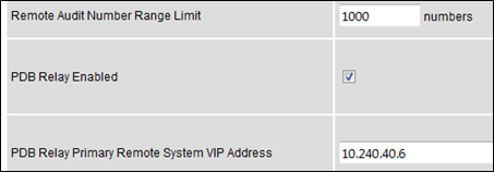

  15. Locate the PDB Relay Enable check box and record if it is checked or not checked.
    Figure A-50 PDB Relay Enable check box
    If the PDB Relay Enabled checkbox is CHECKED, then continue with the next step of this procedure. If the PDB Relay Enabled checkbox is NOT CHECKED, then skip to step 19 of this procedure.
