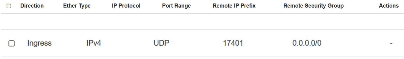

  1. Check the ping request and response packets from Server-A and Server-B for which alarm has been raised, by running the following command:
    tcpdump -i eth1 -n "host <server-A>-imi or <server-B>-imi and port 17401 and udp"
    For example:tcpdump -i eth1 -n "host noam00-17badf67-imi or noam01-17badf67-imi and port 17401 and udp"
  2. If ping request or response packets are not coming from any server, then add security group rule ingress (response) or egress (request) to that instance.
    The following image shows Ingress response:
    Figure 23-1 Ingress Response
    Ingress Response
  3. Check the ping packets again after adding the rule and ensure that imi request and response packets are received from each servers, by running the following command:
    tcpdump -i eth1 -n "<server-A>-imi or <server-B>-imi and port 17401 and udp"

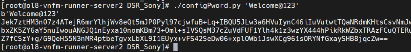

23.11 Changing VNF CLI and DSR GUI Log in Credentials
This section provides information to change VNF CLI and DSR GUI log in username and password.
Prerequisites
  • The new credentials are supported by the DSR Image.
  • The updated username must be a plain text.
  • The updated password must be encrypted using the utility function which is /configPword.py'passwordToBeEncrypted'.
    Following is an example showing the usage of the script:
    Figure 23-2 Usage of Script
    Usage of Script
  • The encrypted password must be updated in VnfmPropeties.yaml file.

  • To change VNF CLI log in username and password, update admUsrUsername and admUsrPword fields.
  • To change the DSR GUI username and password, update dsrNoamUsername and dsrNoamPword fields.
