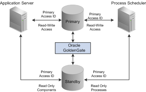

Oracle GoldenGate, with Oracle Database 11g or higher, enables you to off-load resource-intensive activities from a production database to a synchronized standby database. Oracle GoldenGate enables access to a physical standby database for queries, sorting, reporting, web-based access, and so on, while continuously applying changes received from the production database. If you use Oracle GoldenGate at your site, PeopleTools provides the infrastructure to use GoldenGate with your PeopleSoft application databases.
The following diagram depicts how Oracle GoldenGate enables you to incorporate the use of a standby database for you to offload designated read-only transactions, freeing up more resources to handle the read-write transactions on your primary (production) database.
The following table describes the elements within the diagram:

Oracle GoldenGate needs to be licensed, installed, and enabled for your server before you can begin setting up your PeopleSoft system to take advantage of this feature. The primary and standby databases need to be set up according to the Oracle GoldenGate documentation.
The basic configuration for PeopleSoft and Oracle GoldenGate (OGG) consists of two databases, your Primary database and the Standby database. Characteristics of the server connections to these databases are:
Server |
Connection Characteristics |
Application Server |
Process Scheduler Server |
GoldenGate operates between the two databases, sits between the two databases, and manages a set of components associated with each of the databases. Depending on your implementation, one to many of these components may be in use. GoldenGate transaction replication software consists of several key components, including:
GoldenGate Manager process: controls background process behavior.
GoldenGate Extract or Capture component process: extracts data from the online or archive redo log files within an Oracle database.
GoldenGate trail files: store the extracted data as part of the replication processing.
GoldenGate Pump process: moves the data in the trail files from the primary database server to the reporting database server.
GoldenGate Replicate or delivery process: applies the captured data (stored in the trail files) to the target database.
Note: For a GoldenGate environment, the secondary connection to the Standby database utilizes the same login credentials used for the Primary connection.
Note: Whether both databases reside on the same or different servers, GoldenGate binaries need to be installed twice, in two separate directories. One installation is for the Primary database, and the other is for the Standby database.

Creating primepmp.prm
Create a file named primepmp.prm and add the following:
-- Pump for Extract primecap
-- Edit and modify REMOTE Host, Port and Trail Directory
-- Edit and modify 'EMDBO' to PSACCESSID
EXTRACT primepmp
SETENV (ORACLE_SID='CDBPSFT1')
PASSTHRU
PASSTHRUMESSAGES
USERID C##OGGUSER PASSWORD OGGUSER
-- Remote Host and Trail Information
RMTHOST <hostname> MGRPORT 7810
RMTTRAIL ./dirdat/pr
-- Table Mapping Parameters
WILDCARDRESOLVE DYNAMIC
SOURCECATALOG PT855GA
TABLE EMDBO.*;
This section describes the parameter files that you need to create and modify manually for the standby database. These files need to be created in the dirprm directory of your standby Oracle GoldenGate installation. For example, C:\OGG\standby\dirprm. The files you need to create for the standby installation are:
mgr.prm
configure_standby.oby
trgtrep.prm
Creating mgr.prm
Create a file named mgr.prm, and add the following:
-- mgr.prm file
PORT 7810
PURGEOLDEXTRACTS ./dirdat/*, USECHECKPOINTS, MINKEEPDAYS 3
Note: The default GoldenGate port is 7809. When installing twice on the same host, 7810 is the other default port.
Creating configure_standby.oby
Create a file named configure_standby.oby, and add the following”
-- Edit and modify 'OGGUSER' to Oracle GoldenGate Admin Userid and PW
-- Edit and modify REMOTE Host and Trail
dblogin USERID C##OGGUSER@STD855GA password OGGUSER
ADD REPLICAT trgtrep INTEGRATED EXTTRAIL ./dirdat/pr
Creating trgtrep.prm
Create a file named trgtrep.prm, and add the following:
-- Edit and modify NLS_LANG parameter as required (eg. language.territory.character)
-- Edit and modify ORACLE_HOME
-- Edit and modify Primary ORACLE_SID
REPLICAT trgtrep
SETENV (NLS_LANG = "AMERICAN_AMERICA.AL32UTF8")
SETENV (ORACLE_HOME = "C:\oracle12c\product\12.1.0\dbhome_1")
SETENV (ORACLE_SID = "CDBPSFT1")
DBOPTIONS INTEGRATEDPARAMS(parallelism 6)
USERID C##OGGUSER@STD855GA, PASSWORD OGGUSER
ASSUMETARGETDEFS
DISCARDFILE ./dirrpt/trgtrep.dsc, APPEND
DISCARDROLLOVER ON SUNDAY
ALLOWNOOPUPDATES
MAP PT855GA.EMDBO.*, TARGET STD855GA.EMDBO.*;

Normally in a GoldenGate configuration you use GoldenGate to replicate changes made on these tables from the standby to the primary database. PeopleSoft cannot take advantage of GoldenGate's bi-directional replication mechanism due to possible issues in the PeopleSoft reporting infrastructure in an environment where both databases are active at all times. The PeopleSoft reporting infrastructure (Process Scheduler, PSAESRV, PSPRCSRV, DISTSRV, and so on) will not accommodate database synchronization lag time with sequence numbers and instance numbers. To address this issue when using GoldenGate, PeopleSoft needs to utilize Remote Synonyms and Database Links to redirect all DML requested on the standby database to the primary database for a subset of the tables that make up the PeopleSoft reporting infrastructure.
Creating Database Links to the Primary Database
To create database links to the primary database:
Drop ‘Like’ named redirected tables in the standby database.
Prior to creating the database links and the remote synonyms, you need to drop ‘like’ named redirected tables on the standby database by running the following script.
PS_HOME/scripts/dropredirectedtables.sql
Run this script against the standby database connected as the primary access ID in SQLPlus.
Edit the createdblinktoprimary.sql script.
This script creates a fixed database link between the primary access ID on the standby database to the primary access ID on the primary database. Open the createdblinktoprimary.sql script in PS_HOME\scripts, and modify it as follows:
Replace <DBNAME> with the primary database TNSALIAS.
<EMDBO> with the primary access ID.
<PASSWORD> with the primary access ID password.
Run the createdblinktoprimary.sql script.
Run this script against the standby database connected as the primary access ID.
Please make sure that the access ID has "create public database link" privileges or else the above create database link will fail with ORA-01031: insufficient privileges . Grant the
CREATE PUBLIC DATABASE LINKprivilege to the access id on the standby database:$ sqlplus / as sysdba SQL> Alter session set container=PT855GA; Session Altered. SQL> Grant create public database link to EMDBO;
Creating Remote Synonyms
Remote synonyms are required for the tables identified as requiring DML access. If you decide to set a component to "read-only" after your analysis, then you need to include the underlying tables that require DML access to this script manually.
To create remote synonyms, you run the PS_HOME/scripts/createremotesynonyms.sql script. You must run this script against the standby database connected as the primary access ID.
Configuring the Primary and Standby Databases
When working with each database, ensure that the ORACLE_HOME and ORACLE_SID environment variables are set before invoking the GoldenGate command line interpreter (GGSCI). Make sure you invoke GGSCI from $OGG_HOME or add $OGG_HOME to the $PATH environment variable.
To configure the primary and standby databases:
Add supplemental log groups to the primary database.
GGSCI > obey ./priaddtrndata.Configure the GoldenGate processes on the primary database.
GGSCI > obey ./configure_primary.obyConfigure the GoldenGate processes on the standby database.
GGSCI > obey ./configure_standby.oby
Starting the GoldenGate Processes on the Primary and Standby Databases
To start the GoldenGate processes on the primary and standby databases:
Issue the following commands on the primary database server to start the GoldenGate processes:
GGSCI > start manager GGSCI> start primecap GGSCI > info allIssue the following commands on the standby database server to start the GoldenGate processes:
GGSCI > start manager GGSCI > info allIssue the following command on the primary database server to start the GoldenGate pump processes.
GGSCI> start primepmp GGSCI> info allIssue the following command on the standby database server to start the GoldenGate repository processes.
GGSCI> start trgtrep GGSCI> info all
To set up your PeopleSoft system to recognize both the primary and standby databases, as well to recognize the components and processes that will use the GoldenGate implementation, you need to:
Specify the standby database information in the application server and Process Scheduler configuration files.
Configure read-only components.
Configure read-only processes.
The procedures for performing these tasks are identical to those for setting up Oracle ADG.
Note: Its important to understand the inherited behavior for marking a component as RO. If an initial component is marked as RO and this component calls other components, the called components will inherit the RO flag. That is, not only will the initial components SQL be redirected to the STANDBY database, all the SQL from the called components will also be redirected to the STANDBY database. Oracle has accounted for tables that may be involved with DML SQL operations from the supported components and processes listed in Understanding GoldenGate Within PeopleSoft by including those tables in the CREATEREMOTESYNONYM.SQL script. If additional components are marked RO and perform DML SQL operations on any tables not previously accounted for, then REMOTE SYNONYMS must be created for those tables as well.
