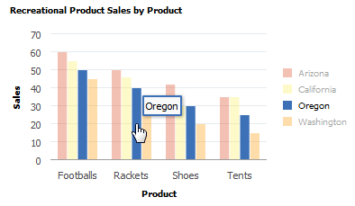

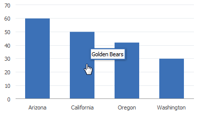

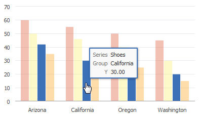

Use the SetDataHints method to override the default text that appears as a caption when you mouse over data in a chart (that is, a bar, a pie slice, or a data point).
Important! The ToolTipLabel class provides an alternative method for creating custom tooltips for data items on charts. See Using the ToolTipLabel Class for more information.
The default data hint text that appears is constructed from information about the composition of the chart that you have defined and the row of data being charted. Specifically, its structure depends on whether the chart has a data series or not.
If you do not specify SetDataHints and do not specify SetDataSeries, then the value of the x-axis (Group) and the value of the y-axis appear in the data hint:
If you do not specify SetDataHints but do specify SetDataSeries, then the value of the x-axis (Group), the y-axis, and the series appear in the data hint:

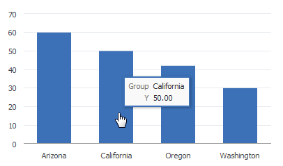

If you use SetDataHints, the text that appears as a caption when you mouse over data will be precisely that which is in the RECORD.FIELD for that row of data. This is true whether a data series is present or not.
For example, SetDataHints is set as follows:
&cChart12.SetDataHints(DOC_CHRT_SLS_2.DOC_CHRT_MASCOT);
Mousing over the bar representing California reveals Golden Bears as the value of the DOC_CHRT_MASCOT field for that row in the DOC_CHRT_SLS_2 rowset:
In the following example, SetDataSeries is already set, and SetDataHints is set as follows:
&cChart13.SetDataHints(DOC_CHRT_SLSREC.DOC_CHRT_RGN);
Mousing over any bar in the bar chart will display the region represented by the bar.

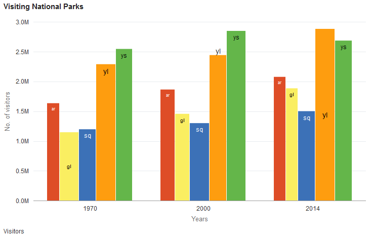

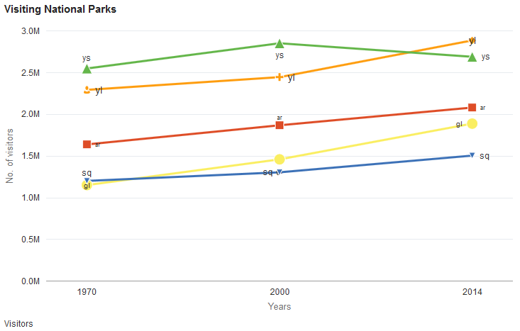

The following PeopleCode program will render the chart data as a bar chart:
rem Set up the chart;
&oChart = GetChart(QE_JET_CHARTWRK.QE_JET2);
&oChart.Reset();
&oChart.Type = %ChartType_2DBar;
rem Set chart data;
&oChart.SetData(Record.QE_CHART_NPARKS);
&oChart.SetDataYAxis(QE_CHART_NPARKS.QE_VISITORS);
&oChart.SetDataXAxis(QE_CHART_NPARKS.QE_YEARS);
&oChart.SetDataSeries(QE_CHART_NPARKS.QE_PARKNAME);
&oChart.XAxisTitle = "Years";
&oChart.YAxisTitle = "No. of visitors";
&oChart.FootNote = "Visitors";
&oChart.MainTitle = "Visiting National Parks";
rem Set data labels and markers;
&oChart.SetDataLabel(QE_CHART_NPARKS.QE_CHART_LABEL);
&oChart.SetDataLabelPosition(QE_CHART_NPARKS.QE_CHART_POS);
&oChart.SetDataLabelStyle(QE_CHART_NPARKS.QE_CHART_LABELSTYL);
&oChart.SetDataMarker(QE_CHART_NPARKS.QE_CHART_MARKER);
&oChart.SetDataMarkerSize(QE_CHART_NPARKS.QE_CHART_MARKERSIZ);
rem Set z-axis value;
&oChart.SetDataZAxis(QE_CHART_NPARKS.QE_CHART_Z);
rem for bubble charts;
rem &oChart.SetDataGlyphScale(QE_CHART_NPARKS.QE_CHART_Z);
Because bar charts do not support data markers, the chart that is rendered does not display markers.
The preceding PeopleCode program can be modified to display the same data as a line chart by changing the chart type:
&oChart.Type = %ChartType_2DLine;
The line chart that is rendered from the same data includes the data labels and data markers.

Example
Syntax
SetDataLabelStyle(Record_Name.Field_Name1, ...)
Description
Use the SetDataLabelStyle method to set a string defining the CSS style for the data label.
Parameters
Parameter |
Description |
Record_Name.Field_Name1, ... |
Specify the name of the record and one or more fields on that record that contain the CSS styles for the data labels for the chart. Note: The order of fields specified must correspond to the number and order specified by the SetDataYAxis method. |
Returns
None.
Example
Syntax
SetDataMarker(Record_Name.Field_Name1, ...)
Description
Use the SetDataMarker method to set the shape of data markers, which can be used to highlight certain data points on a chart. Data markers can be used only with line charts, bubble charts, and scatter charts.
The String value of this field must be one of these values:
Value |
Description |
square |
Square |
circle |
Circle |
diamond |
Diamond |
plus |
Plus sign |
triangleDown |
Triangle with tip down |
triangleUp |
Triangle with tip up |
human |
Human |
auto |
Automatically selected by the chart engine |
Parameters
Parameter |
Description |
Specify the name of the record and one or more fields on that record that contain the data for the data marker types for the chart. Note: The order of fields specified must correspond to the number and order specified by the SetDataYAxis method. |
Returns
None.
Example
&oChart.SetDataMarkerSize(QE_CHART_NPARKS.QE_CHART_MARKER);

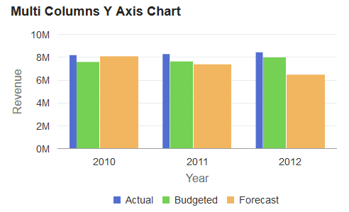

Since the SetDataYAxis method now allows you to specify multiple RECORD.FIELD parameters, you can specify data from multiple columns from the same data record. Doing so reduces the need to have duplicate data in row format. The following PeopleCode program could be used to display the preceding data:
rem Initialize the chart;
&Chart = GetChart(QE_COL_MULTIWRK.QE_CHART_FIELD);
&Chart.Reset();
rem Call function to check the chart type;
&Chart.Type = %ChartType_2DBar;
rem Set chart data record;
&Chart.SetData(Record.QE_COL_MULTI);
rem Set the x-axis;
&Chart.SetDataXAxis(QE_COL_MULTI.LY_YEARS);
rem Set multiple y-axis data columns;
&Chart.SetDataYAxis(QE_COL_MULTI.LY_AMOUNT_ACTUAL, QE_COL_MULTI.LY_AMOUNT_BUDGET, QE_COL_MULTI.LY_AMOUNT_FORCAST);
rem Set multi y-axis colors;
&Chart.SetDataColor(QE_COL_MULTI.LY_CHART_COLOR_1, QE_COL_MULTI.LY_CHART_COLOR_2, QE_COL_MULTI.LY_CHART_COLOR_3);
rem Set multi-column item size;
&Chart.SetDataZAxis(QE_COL_MULTI.LY_CHART_GLYPHSCL1, QE_COL_MULTI.LY_CHART_GLYPHSCL2, QE_COL_MULTI.LY_CHART_GLYPHSCL3);
rem Need labels for all y columns, which now act like series here;
&Chart.SetSeriesLabels(CreateArray("Actual", "Budgeted", "Forecast"));
&Chart.MainTitle = "Multi Columns Y Axis Chart";
&Chart.XAxisTitle = "Year";
&Chart.YAxisTitle = "Revenue";
rem Set the chart legend;
&Chart.HasLegend = True;
&Chart.LegendPosition = %ChartLegend_Bottom;
&Chart.IsDrillable = True;
&Chart.SetDataURLs(QE_COL_MULTI.LY_CHRT_URL_1, QE_COL_MULTI.LY_CHRT_URL_2, QE_COL_MULTI.LY_CHRT_URL_3);
The preceding PeopleCode would produce the following chart:
If the SetDataZAxis method is commented out of the preceding PeopleCode, the following chart with equal width bars is produced instead:
rem &Chart.SetDataZAxis(QE_COL_MULTI.LY_CHART_GLYPHSCL1,

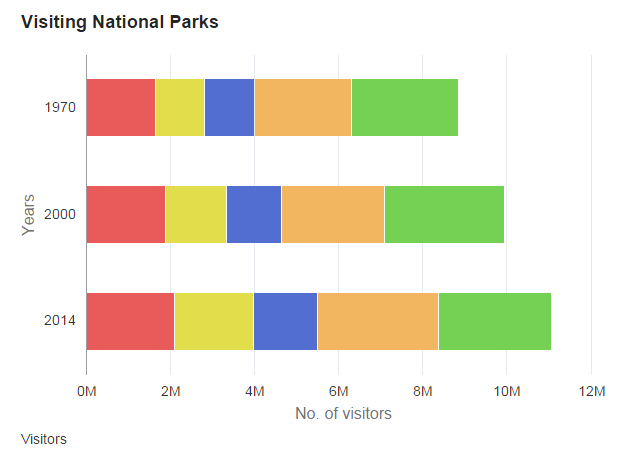

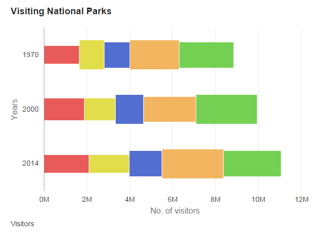

Because no z-axis data is specified for the following stacked horizontal bar chart, the height of each bar is the same.
Because z-axis data is specified for the following stacked horizontal bar chart, the height of each bar varies according to the data value.

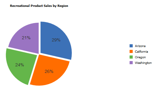

Example
Local array of number &ExplodedArray;
&ExplodedArray = CreateArray(1,2,3,4,5)
&cChart.SetExplodedSectorsArray(&ExplodedArray);
The following example shows an exploded 2D pie chart:
