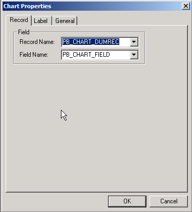

Associating the Chart Control with a Record Field
Each chart on a component must be associated with a unique field. Double-click the chart control to access the Chart Properties dialog box and enter a record name and field name.
The chart field has no special requirements. Its only purpose is to provide a reference to the field in PeopleCode.
This sample chart uses a derived/work record named DOC_CHRT_WRK that is dedicated to this purpose.

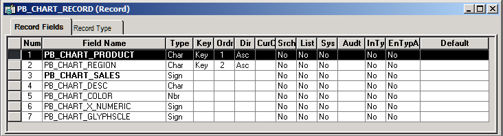

Creating the Chart Data Record
The chart needs either a record or a rowset to serve as the data source. This sample chart uses a record. See the Chart class SetData method for details about using a rowset.
See SetData.
At a minimum, the record must have fields for the x-axis data and the y-axis data. Optionally, the record can have fields for series data, chart color, and glyph size.
The record must be available in the component buffer at runtime. You can use a database record that is already part of your application or you can use a derived/work record or a component rowset that you populate at runtime. For greatest control, you will normally populate your record or rowset at runtime.

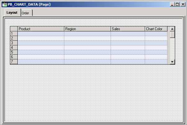

For the sample chart, place the record on a grid on a second page on the sample component. This placement gives you the opportunity to experiment with the data.
Your chart data record must be placed at level 1 on the same component as the chart so that the data is available in the component buffer at runtime. In your application, you can hide the grids or scroll areas that hold the records. For the sample chart, you will keep the grid visible so you can enter sample data.

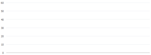

Viewing the Page in the Browser
This is the most basic Chart class chart. It has no data and only the default y-axis.

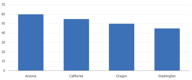

This bar chart is generated by the example code and data:
This chart graphs sales on the y-axis (the vertical axis) and regions on the x-axis (the horizontal axis).
When the data for the chart is grouped according to values, a set of data representing a single value is called a series. For instance, if a chart shows sales for different products in each region, then the set of data for each product is a series.
At this point, the chart has only one series, so you do not need to set the series record field.

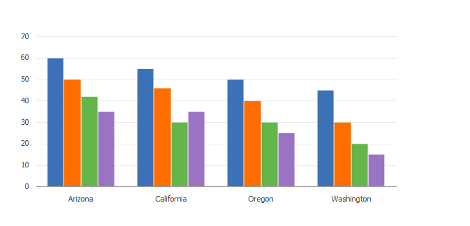

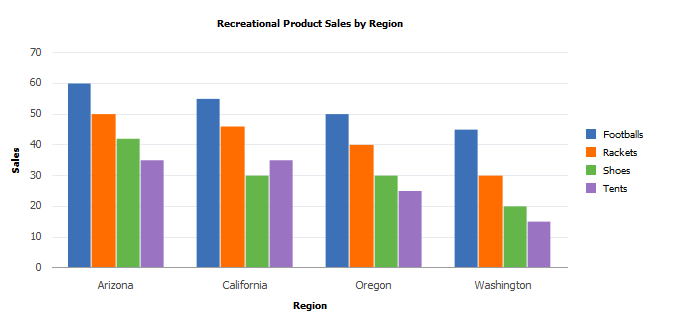

The resulting chart is a default 2D bar chart with bars for each region grouped by series:
The chart has four series:
Footballs
Rackets
Shoes
Tents
Each series shows four regions along the x-axis:
Arizona
California
Oregon
Washington
Sales values appear against the y-axis as bar height.
The chart uses the default colors.

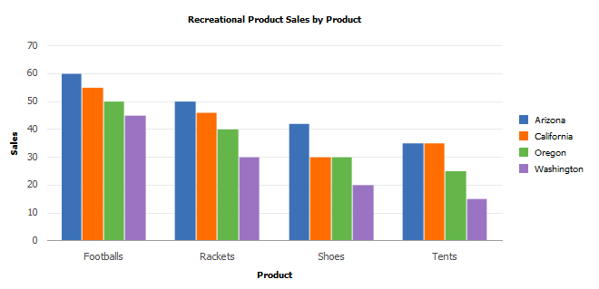

Changing X-Axis and Series Values
&cChart2.SetDataXAxis(DOC_CHRT_SLSREC.DOC_CHRT_PRDCT);
&cChart2.SetDataSeries(DOC_CHRT_SLSREC.DOC_CHRT_RGN);
&cChart2.MainTitle = "Recreational Product Sales by Product";
&cChart2.XAxisTitle = "Product";
To group sales by product instead of by region, switch the series and the x-axis. You will also need to reorder colors to correspond to regions instead of products:

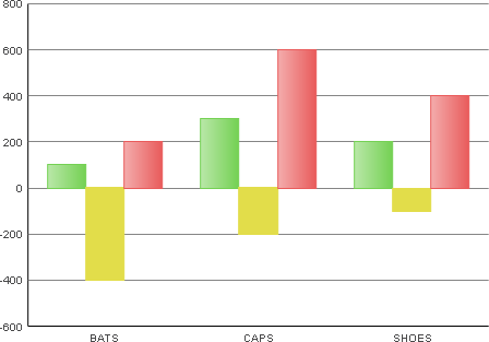

If your chart has negative values, the bars automatically extend below the x-axis:

2D Bar Chart
&cChart.Type=%ChartType_2DBar;
The default Chart class chart type is a 2D bar chart:

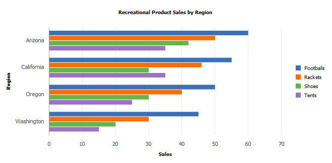

Horizontal Bar Chart
Use this line of code to specify a horizontal bar chart:
&cChart.Type = %ChartType_2DHorizBar;
This example illustrates a horizontal bar chart:

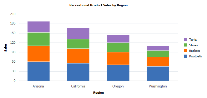

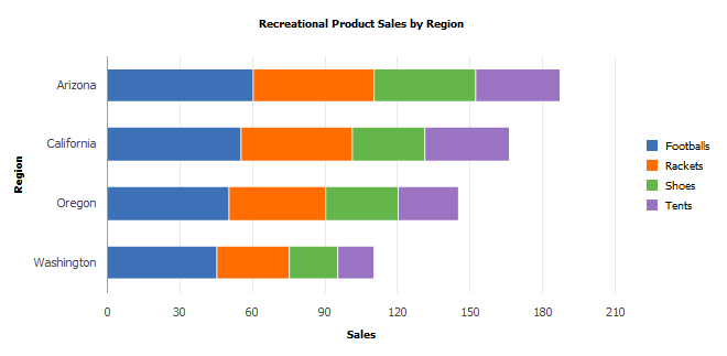

Stacked Bar Chart
With a the stacked bar chart, you can place a different emphasis on the same data. The stacked column shows total sales per region as well as the product segments that contribute to the total.
Use this line of code to specify a stacked bar chart:
&cChart.Type = %ChartType_2DStackedBar;
This example illustrates a stacked bar chart:

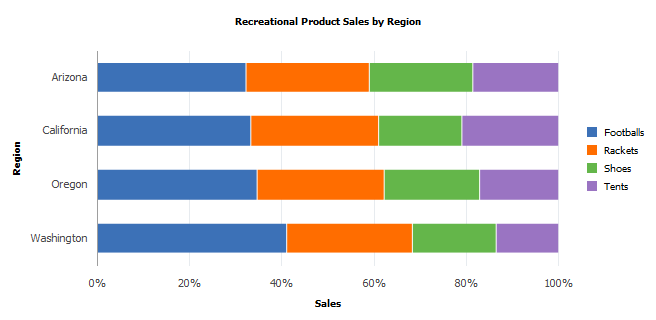

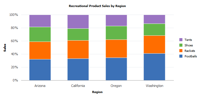

Percent Bar Chart
A percent bar is similar to a stacked bar, but the segments of each bar add up to 100. The segments show the proportional contribution of each product to total sales.
Note: Negative values cannot be displayed in any type of percent bar chart.
Use this line of code to specify a stacked percent bar chart:
&cChart.Type = %ChartType_2DPercentBar;
This example illustrates a percent bar chart:

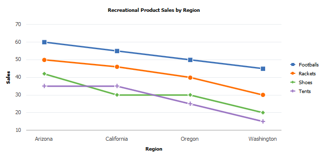

Line Chart
A line chart is useful for showing changes and trends over time or across categories.
Use this line of code to specify a line chart:
&cChart.Type = %ChartType_2DLine;
This example illustrates a line chart:

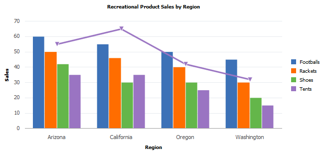

Overlay Chart
You can overlay one chart on top of another to compare two different but related sets of data. The following chart uses a second set of data, showing average temperature for each region.
Use the OLType property to specify whether the overlay is a line chart or a histogram.
Add this PeopleCode to the PeopleCode for your bar chart to create 2D line chart overlay:
/* Create Overlay */
&cChart3.SetOLData(Record.DOC_CHRT_OLREC);
rem &cChart.SetOLDataSeries(DOC_CHRT_OLREC.SC_CHART_SERIES);
&cChart3.SetOLDataXAxis(DOC_CHRT_OLREC.DOC_CHRT_RGN);
&cChart3.SetOLDataYAxis(DOC_CHRT_OLREC.DOC_CHRT_SALES);
&cChart3.OLType = %ChartType_2DLine;
This example illustrates a 2D line chart overlay on a vertical bar chart:

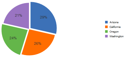

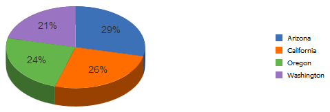

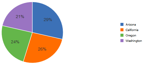

Pie Chart
A pie chart shows comparisons within a single set of values, and it shows how parts contribute to a whole. It is an ideal chart type to display the contribution of each region to an annual sales total.
A pie chart ignores the series and only plots x-axis data against y-axis values. Our original bar chart has four regions times four products, resulting in 16 XY pairs. A pie chart with all of those slices would be confusing and not helpful. Instead, suppose you want to show just the data for tents, which are in rows 13–16. You can use a combination of the DataWidth and DataStartRow properties to select which rows to display.
You can make a pie chart showing only rows 13–16 by adding this snippet of code:
&cChart.DataWidth = 4;
&cChart.DataStartRow = 13;
&cChart.Type = %ChartType_2DPie;
This example illustrates a 2D pie chart generated from a portion of the rowset:
Exploded Pie Chart
Use the SetExplodedSectorsArray Chart class method to specify the sectors to explode. Sectors correspond to rows of data used by the pie chart. Sector 1 is the first row of data, or the row specified with the DataStartRow chart class property, if it is used, and so on.
The following snippet of code explodes sectors 1 and 3:
Local array of number &ExplodedArray;
&ExplodedArray = CreateArray(1,3);
&cChart.SetExplodedSectorsArray(&ExplodedArray);
This example illustrates an exploded pie chart:
See the SetExplodedSectorsArray property.
3D Pie Chart
Use this line of code to specify a 3D pie chart:
&cChart.Type = %ChartType_3DPie;
This example illustrates a 3D pie chart.

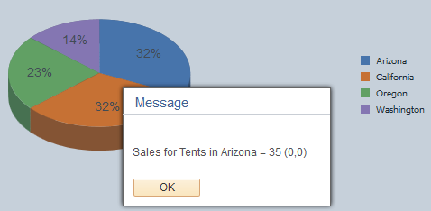

Adding Drilldown
If you set the property IsDrillable to True and add FieldChange PeopleCode to your chart, your user can get more information by clicking a chart data element—a bar, line segment, data point, or pie slice.
For a simple example, add this PeopleCode to the FieldChange event on the y-axis field:
MessageBox(0, "", 0, 0, "Sales for " | DOC_CHRT_SLSREC.DOC_CHRT_PRDCT | " in " | DOC_CHRT_SLSREC.DOC_CHRT_RGN | " = " | DOC_CHRT_SLSREC.DOC_CHRT_SALES | "");
And add this code to the page Activate event for your pie chart:
&cChart.IsDrillable = True;
When the user clicks the Arizona slice of the pie chart, this message appears:
Current context provides the values for fields in the current row in the component buffer. You can use drilldown with your chart data fields along with any other data in the component buffer to accomplish anything FieldChange PeopleCode is capable of.

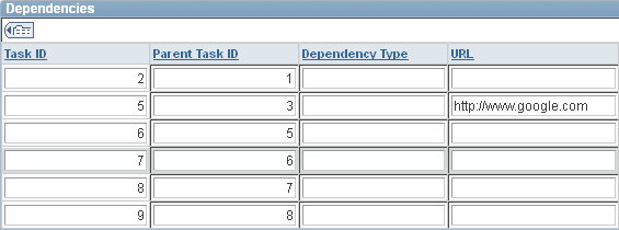

This example uses the following data in the record QE_GANTT_TASK:
This example illustrates Gantt task data:
The chart also uses the following dependency data in the record QE_GANTT_TASKD:
This example illustrates Gantt dependency data:

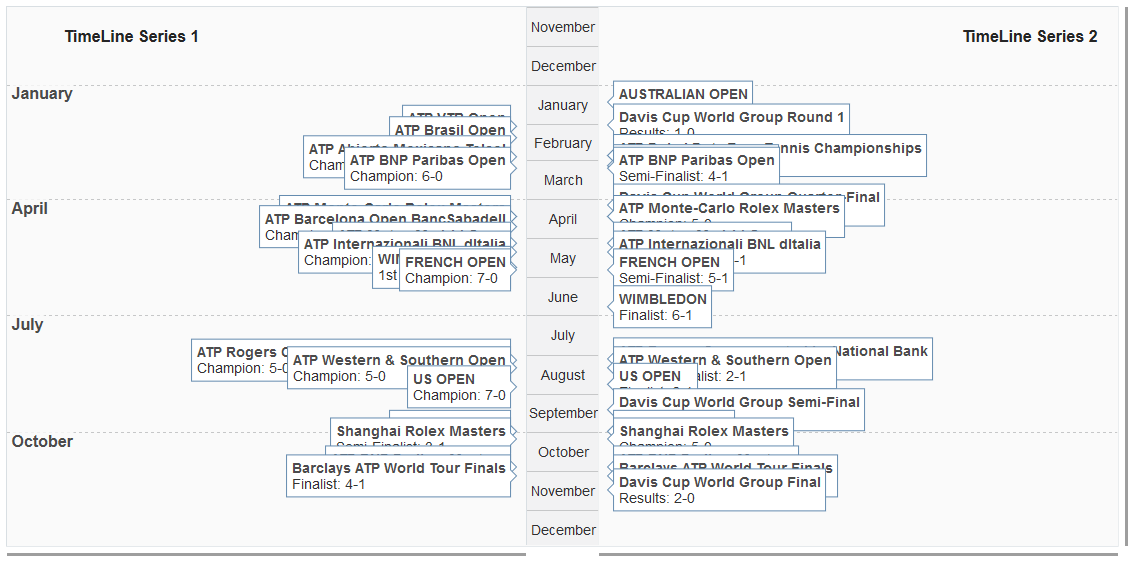

The preceding lines of PeopleCode generate the following timeline chart assuming that sample data is provided for the chart.
A resulting timeline chart.
