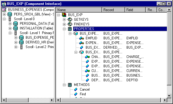

In this example, you are getting a existing instance of data for the BUS_EXP Component Interface, which is based on the BUSINESS_EXPENSES component, then inserting (or deleting) a row of data in the second level scroll.
This example illustrates the fields and controls on the BUS_EXP Component Interface definition. You can find definitions for the fields and controls later on this page.
The following is the complete code sample: the steps explain each line.
Local ApiObject &MYSESSION;
Local ApiObject &MYCI;
&MYSESSION = %Session;
&MYCI = &MYSESSION.GetCompIntfc(COMPINTFC.BUS_EXP);
&MYCI.EMPLID= "8001";
&MYCI.Get();
&MYLEVEL1 = &MYCI.BUS_EXPENSE_PER;

Get a session object.
Before you can get a Component Interface, you have to get a session object. The session controls access to the Component Interface, provides error tracing, enables you to set the runtime environment, and so on.
&MYSESSION = %Session;Get a Component Interface.
Use the GetCompIntfc method with a session object to get the Component Interface. You must specify a Component Interface definition that has already been created. You receive a runtime error if you specify a Component Interface that doesn’t exist.
&MYCI = &MYSESSION.GetCompIntfc(COMPINTFC.BUS_EXP);After you execute the GetCompIntfc method, you have only the structure of the Component Interface. You haven’t populated the Component Interface with data yet.
Set the GETKEYS.
These are the key values required to return a unique instance of existing data. If the keys you specify allow for more than one instance of the data to be returned, or if no instance of the data matching the key values is found, you receive a runtime error.
&MYCI.EMPLID = "8001";Get the instance of data for the Component Interface.
After you set the key values, you must use the Get method.
&MYCI.Get();This populates the Component Interface with data, based on the key values you set.
Get the level one scroll.
The name of the scroll can be treated like a property. It returns a data collection that contains all the level one data.
&MYLEVEL1 = &MYCI.BUS_EXPENSE_PERGet the appropriate item in the level one data collection.
