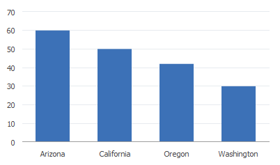

For example, this is the minimum PeopleCode to create a bar chart using the Chart class.
/* Declare and instantiate a chart object; */ Component Chart &cChart11; &cChart11 = GetChart(DOC_CHRT_WRK.DOC_CHRT_FLD_11); /* Set the chart data record and specify x-axis, y-axis, and series data; */ &cChart11.SetData(Record.DOC_CHRT_SLS_2); &cChart11.SetDataXAxis(DOC_CHRT_SLS_2.DOC_CHRT_RGN); &cChart11.SetDataYAxis(DOC_CHRT_SLS_2.DOC_CHRT_SALES);View the chart in the browser.
Suppose you have this data in DOC_CHRT_SLSREC:
Region
Sales
Arizona
62
California
50
Oregon
42
Washington
50
This is the bar chart generated by the example code and data. The default chart type for the Chart class is a bar chart. Since no colors are specified, the chart uses the default colors.
This example illustrates a simple bar chart:
