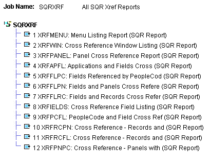

generates the following HTML file:
The following image is an example of an HTML file generated after executing the above mentioned PeopleCode program:

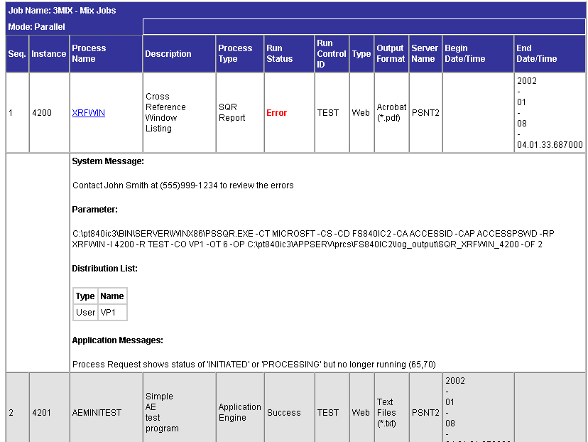

The following screen image is an example of a HTML report created after executing the above mentioned PeopleCode program:

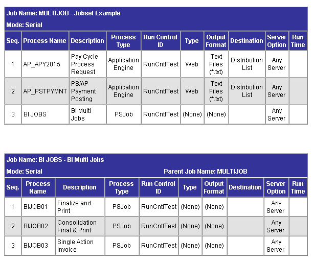

Creates the following HTML report:
