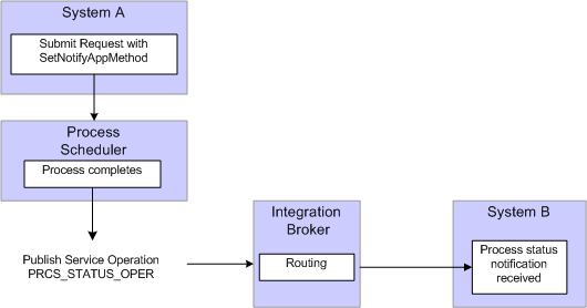

SetNotifyAppMethod
This method allows you to create your own application class to handle the notification and information you want to send. This method will invoke the service operation PRCS_STATUS_OPER, as shown in this diagram:
This example illustrates how to create application class that handles the notification and information through PRCS_STATUS_OPER service operation.

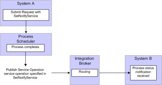

SetNotifyService
This method requires you to create your own service operation and service operation handler to publish the message when the process request completes.
This example illustrates how to create service operation and service operation handler to publish messages.

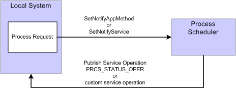

This diagram illustrates how you can set up process status notification to run locally:
This diagram illustrates how you can set up process status notification to run locally.

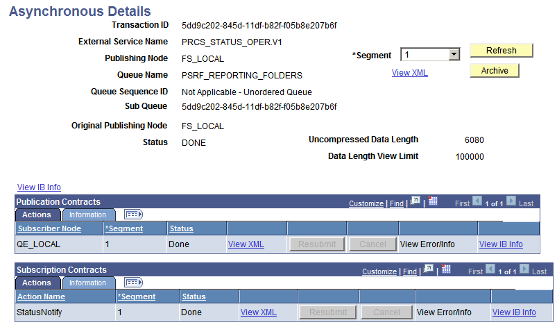

Click the Details link for your Transaction Id.
This is an example of the asynchronous details page. If any errors occur, the View Error/Info link can be used to view the error message. The View XML link will display the XML message.
Note: The message may contain report instance related information for process requests with an output type of Web or Windows. Refer to the message PRCS_STATUS_MSG for the details on the fields that are published. (Select PeopleTools, Integration Broker, Integration Setup, Messages and search for message name PRCS_STATUS_MSG).
This example illustrates the fields and controls on the Asynchronous details page.
