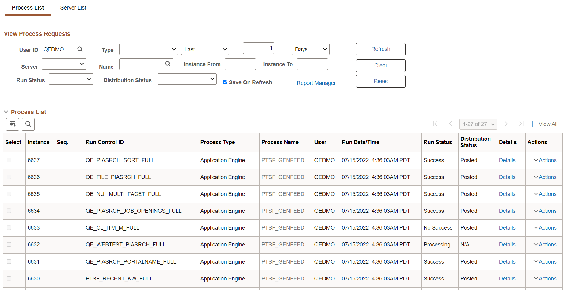

To access the Process List page, select
This example illustrates the fields and controls on the Process List page. You can find definitions for the fields and controls later on this page.
Field or Control |
Description |
User ID |
View the processes submitted by a user ID. Usually, you view your own user ID. Leave blank to view all of the processes that you are authorized to view. |
Type |
View by a process type, such as Application Engine, COBOL, SQR, or Application Engine. |
All or Last or Date Range |
Specify an interval of time by which to limit the process requests that appear in the list. When you select All, the time interval fields are grayed out and all process requests appear. Select Last to display only those reports that were created in the last number of days, hours, years, or minutes. Enter a custom numerical value in the field and then select a unit type: Days, Hours, Years, or Minutes. Select Date Range to display only those reports created between two specific dates. Enter a From date and a To date. |
Refresh |
After selecting your filtering options, select Refresh to display the filtered processes. |
Clear |
Select to clear the filters and set them to their default values. |
Reset |
Select to reset the filters to the last saved values in the database. |
Server |
View processes that are run on a particular server. |
Name |
View processes by a process name. Note: You will not be able to select a value for this field until you first select a process type. |
Instance |
Specify an instance by which to limit the process requests that appear in the list. To limit the view to a single request, enter the required instance ID in the text field. To specify a range of instances, click the Range hyperlink, so that the label Instance changes to Instance From and an additional field named Instance To appears. |
Report Manager |
Select to go to the Report Manager page. |
Run Status |
View processes by status, such as Success or Error. |
Distribution Status |
View processes by distribution, such as Generated or Posted. |
Save on Refresh |
Select the check box to save changes to filter criteria when you select the Refresh button. The rules applying to Save on Refresh are listed later in this section. |
Select All and Deselect All |
The Select All and Deselect All buttons appear at the bottom of the page when the process list contains processes that can be deleted, cancelled, held, or restarted. Select Select All to select all valid processes. Once selected, select Delete Request to delete all the selected processes. Click Cancel Request to cancel all of the selected processes. Click Hold Request to hold all of the selected processes. Click Restart Request to restart multiple processes or jobs that are on hold. Click Deselect All to deselect all valid processes. Use the check box that appears to the left of each process to select individual processes. The check box is only active for valid processes. Note: The Delete, Cancel, Hold, and Restart options can be performed only on processes with specific run statuses. Therefore, the options will only be visible when processes are filtered by a valid run status for that option. |
Instance |
Displays the process instance; that is, the order in which the process appears in the queue. This number is generated automatically. |
Seq (sequence) |
Within a PSJob, each process request has a defined sequence in which it runs in relation to the others. This column displays this sequence, such as 1, 2, 3, and so on. |
Run Control ID |
Displays the Run Control ID of the process, which helps you identify processes with the same process name but different Run Control ID. |
Process Type |
Displays the type of process, such as Application Engine, COBOL, or SQL. |
Process Name |
Displays the name of the process. When a job or jobset is listed, only the main job appears and the system displays its name as the link. When you search by a process instance of a process which is a job item, the system displays its name as a link. Click to see the status of all jobs and processes that are attached to the main job. |
User |
Displays the user ID of the person who submitted the request. |
Run Date/Time |
Displays the time and date at which the process request was created. |
Run Status |
Indicates the status of the process, such as Queued, Initiated, or Cancelled. A complete list of Run Status values appears later in this section. |
Displays the distribution status for each individual job and process. Valid states are: N/A, None, Generated (OS/390), Not Posted, Posting, and Posted. Note: If the Inter-Domain Gateway connections are done as per Push Notification configurations, Run Status Changes will get automatically updated for the processes or jobs in the list. |
Details |
Click to display the Process Details page. |
Actions |
Click the Actions menu for a list of related actions that can be performed on the current process: Update Process: Select to view a list of actions that can be performed on the process based on the current run status of the process. The options enabled here will be the same as the actions available under Update Process of the Process Detail page. See the Update Process section in Viewing Process Details for a list of valid actions that can be performed on the process. Parameters: Select to view the process request parameters for the process. Message Log: Select to view the message log for the process. Batch Timings: Select to view the batch timings of the process. View Log/Trace: Select to view the process log or trace details for the process. Note: The options displayed on the list depends on the current run status of the scheduled process request. |
See Understanding Jobs and JobSets, Defining Recurrence Definitions.

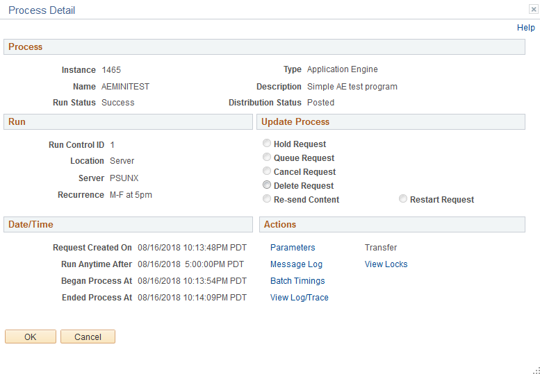

To access the Process Detail page, select the Details link on the Process List page.
This example illustrates the fields and controls on the Process Detail page.
Use the Process Detail page to view details, such as request parameters, message logs, and any recovery instances that have been run. Many of the items on this page are display-only. However, you can use some controls to manipulate the program run.
Note: You must select OK to confirm the Update Process request on the Process Detail page.
Process
This display-only group box contains general descriptive information to help you identify the process request, including the run and distribution states.
Run
Field or Control |
Description |
Run Control ID and Location |
Displays the run control ID and the run location. |
Server |
Displays the name of the server used, if the process runs on the server. Note: When the process is in queue status, the name of the requested server is appears. |
Recurrence |
Displays the recurrence name if this process has a recurring schedule. |
Current Step |
For Application Engine Process Type only. The Step this Application Engine process is currently executing appears in PROGNAME.SECTION.Step format. |
Update Process
The actions that are available in this group box depend on your user authorizations and the current status of the request. This group box is available only if your user ID is authorized to update the selected request.
The option that you select depends on the current run status of the process request. For instance, you cannot cancel a job that has already completed, and you cannot hold a request that is currently processing. The valid actions based on the current status of each process request appear in the following table:
Current Status |
Valid Actions |
Blocked |
Hold, Cancel |
Cancelled |
Delete |
Error |
Delete |
Hold |
Delete, Cancel, Restart |
Initiated |
Cancel |
No Success |
Delete |
Pending |
Hold, Cancel |
Processing |
Cancel |
Queued |
Hold, Cancel |
Restart |
Hold, Cancel |
Success |
Delete |
Warning |
Delete |
Note: The action Resend Content is available when the Distribution Status for a process is Not Posted.
Date/Time
Field or Control |
Description |
Request Created On |
Displays the date and time at which the request appeared in the Process Request table (PSPRCSRQST). This is the same as the Start Request field on the Recurrence Definition page. |
Run Anytime After |
Indicates the date and time at which the user selected File, Run in a PeopleSoft application. |
Began Process At |
Displays the actual date and time at which the process was selected and initiated. For server-based requests, a large gap may exist between the Request Created On and Began Process At values because of PeopleSoft Process Scheduler Server Agent sleep time and other server processing activity. |
Ended Process At |
Indicates the date and time at which the selected process status updated to Success. |
Note: If the request fails at initiation, the begin and end times do not appear.
Actions
This group box contains links to other pages, including Parameters, Message Log, Batch Timings, Transfer, and Temp Tables, and View Log/Trace. These pages provide additional details about the process.
Additional information about these actions is provided in the following Viewing Process Detail Actions section of this topic.

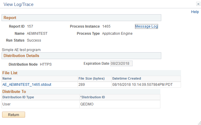

Viewing Log and Trace Files
Click the View Log/Trace link on the Process Detail page to access the View Log/Trace page.
This example illustrates the fields and controls on the View Log/Trace page.
The View Log/Trace page enables you to view the output file, message log and trace file in a browser. The View Log/Trace link appears active on the Process Detail page when at least one of the following conditions is met:
The output destination for the process request is Web, and the report and log files were successfully posted to the Report Repository by the Distribution Agent.
The process must have a run status of Success.
If the report has not been transferred to the Report Repository, the run status of the process request remains Processing and the View Log/Trace link is not active.
If the status of the request remains Processing, check the message log for messages from the Distribution Agent indicating that problems occurred while transferring files to the Report Repository.
The process request ran from a PeopleSoft Process Scheduler Server Agent that was set up using the Server Definition page with a distribution node.
You must have also selected to transfer log files to the Report Repository when you set up the preferences on this page.
