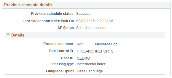

After the PTSF_GENFEED program begins to run, you can view the details which display on the Build Search Index page for that run control ID.
Note: The Details section shows the results of the most recent feed generation for this Search Definition. It may not be the same run control ID as the one you selected. If the run control ID differs from the one you selected, it will be highlighted.
This example illustrates the fields and controls on the Previous schedule details. You can find definitions for the fields and controls later on this page.
Field or Control |
Description |
Previous schedule status |
Displays the status of the most recently executed index build process. When errors occur while processing attachments, an Error link is displayed. Click the Error link to view the exceptions on the Attachment Transfer Exception Details page. |
Last Successful Index Built On |
Displays the date when the index was built successfully. If an index was never built, it displays Never. |
AE Status |
Indicates whether the most recently executed PTSF_GENFEED Application Program ran to completion. If the index build fails, this field displays the step where the process failed. |
Resume schedule |
Appears in the case where the index build failed. If the index build fails, you can use the Rebuild index option to regenerate the index. If the build fails, see Handling Common Errors to determine the cause of the failure to build an index. |
Process Instance |
Indicates whether the system successfully created the output that is required to populate the index. |
Run Control ID |
Displays the run control ID used to generate the index. |
User ID |
Displays the User ID who ran the run control, which may be a different user ID than the user who created the run control. |
Indexing Type |
Displays the index type (Full Index or Incremental Index). |
Language Option |
Displays the language options selected for the index build process (All Languages or Base Language). |

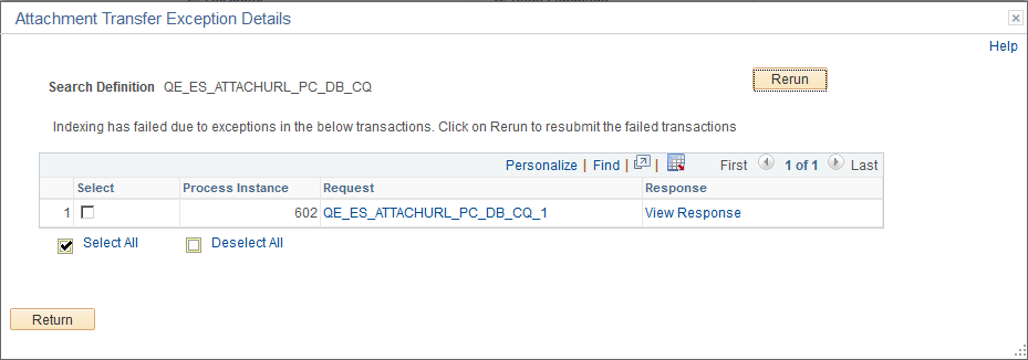

In the Previous schedule details section, select the Error link to view the details of exceptions with respect to attachment processing.
This example illustrates the fields and controls on the Attachment Transfer Exception Details page. You can find definitions for the fields and controls later on this page.
Field or Control |
Description |
Process Instance |
The process instance ID of the PTSF_GENFEED Application Engine program that is causing the exception. |
Request |
The request sent by the PTSF_GENFEED Application Engine program to the search engine. |
Response |
The response received by the PTSF_GENFEED Application Engine program from the search engine. |
Rerun |
Use the Rerun button to resubmit the selected transactions to the search engine. In the case where the maximum exceptions limit is not reached, when you select the Rerun button, the transactions are directly submitted to the search engine without re-execution of the PTSF_GENFEED Application Engine program. In the case where the maximum exceptions limit is reached, the Rerun button acts as a re-submit of the PTSF_GENFEED Application Engine program. |

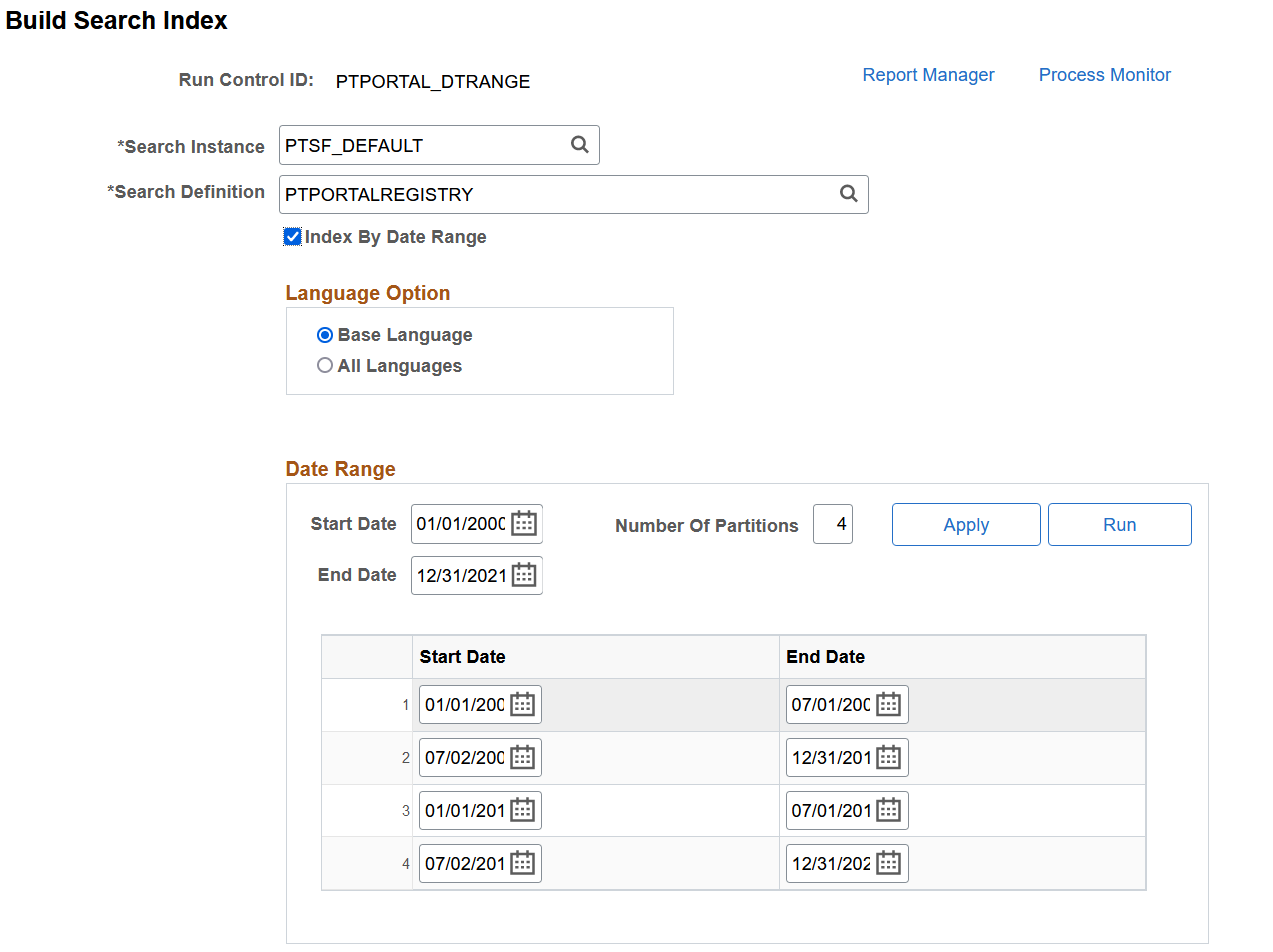

Indexing of search definitions that have reasonably large data volume can pose performance issues. To overcome such performance issues, PeopleSoft Search Framework enables you to partition the application data using the Index by Date Range option. After the date range and number of partitions are specified, the Partition Manager partitions the date range into equal date spans based on the number of partitions. The search index build process creates multiple PTSF_GENFEED Application Engine programs to run the query on the partitioned data. The search index build process also creates multiple run control IDs based on the number of partitions that enables you to re-run any of the run control IDs associated with a partition. The partitioning of application data is performed based on the date range and the number of partitions that are specified.
You can specify the number of partitions, but you cannot control the date span within a date range that is allotted for each partition. The Partition Manager allots the date span for the number of partitions specified by you. However, the Partition Manager does not consider data concentration to come up with the ranges. Hence, in case of large data volumes, the data distribution may not be equal for each partition range, resulting in some processes taking huge loads. Search Framework allows you to adjust these date ranges as needed to create an evenly spread data volume to index.
Partitioning of application data works best when the volume of data is evenly spread over the specified date range. The purpose of partitioning is to divide the data volume into chunks and to run a connected query on the partitioned data, so when you plan to use the partitioning option, you must consider whether the search documents for a specific search definition are spread evenly over a specific date range. That is, if within a date range, for example, 01/01/2017 to 03/31/2017, a huge volume of search data is concentrated in the month of March and the other two months have few attachments, and you specify 3 partitions, then the partitioning may not be very effective because only one partition may get the bulk of the search documents, so you may still face performance issues.
The naming convention followed for run control IDs that are generated for each partition is as follows: _<USERID>_RUNCNTL_<TIME>_<SEQUENCE NUMBER>
For example, _QEDMO_RUNCNTL_020022_2
Note: Partitioning is available for both full and incremental indexing. However, Oracle PeopleSoft recommends that you use partitioning only with full indexing.
This example illustrates the fields and controls on the Build Search Index page after enabling the Index by Date Range option. You can find definitions for the fields and controls later on this page.
Field or Control |
Description |
Start Date |
Specify the start date of the date range. |
End Date |
Specify the end date of the date range. |
Number of Partitions |
Enter the number of partitions you want the search index build process to create. |
Apply |
When you select the Apply button, Partition Manager creates partitions based on the specified number. You can then modify the date ranges. Note: Save the settings before you select the Run button. |

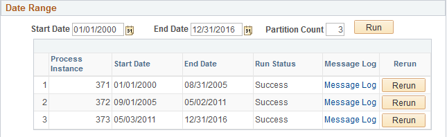

After you use the partitioning option and run the indexing process, the Build Search Index page displays the following information.
Note: Do not use Date Range partitioning on any index that uses preprocessing unless the preprocessing has been modified to also use the date ranges. If you use Date Range partitioning on an index that uses preprocessing, it may cause unintended results.
This example illustrates the fields and controls on the Date Range grid. You can find definitions for the fields and controls later on this page.
Field or Control |
Description |
Process Instance |
Search index build process creates multiple PTSF_GENFEED Application Engine programs for the specified number of partitions. Displays the process instance for each partition. |
Start Date |
Displays the start date (within the specified date range) for each partition. |
End Date |
Displays the end date (within the specified date range) for each partition. |
Run Status |
Displays the status of each process instance. |
Message Log |
If the run status displays error status, use the Message Log link to view the error message. |
Rerun |
Use the Rerun button to run the partitioned process again. |
