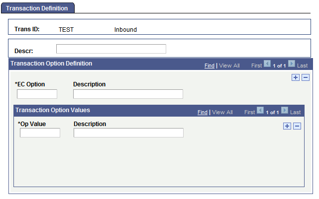

This example illustrates the fields and controls on the Transaction Definition page.
To define a transaction:
Add a new value and enter a unique EC transaction ID as it will appear in PeopleSoft business documents.
Specify whether you are setting up an ID for inbound or outbound transactions.
Note: If you support both inbound and outbound transactions of the same transaction type, you must define two transaction IDs.
Click the Add button.
The Transaction Definition page appears. You use this page to define the transaction and specify any special transaction parameters.
Enter a description of the transaction in the Descr (description) text box.
The description appears in list boxes when you need to select a transaction ID.
Enter the name of a transaction option that the application load or application extract process uses.
Use the EC Option text box to specify a transaction parameter that the system will use when it copies data from the electronic commerce staging tables to the transactional application tables.
Enter the valid transaction option values for the transaction option.
List the valid values in the Op Value field for the transaction option that you specified in the previous step. Add a row for each option value. When you define a trading partner, you will specify which of these values to use for that partner. In this way, the application load or application extract process can handle the transaction differently depending on the trading partner that it comes from.
Repeat steps 5 and 6 to define additional transaction options.

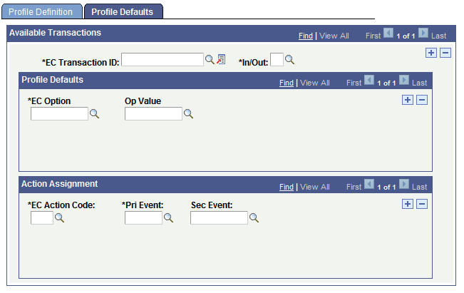

This example illustrates the fields and controls on the Partner Profile - Profile Defaults page.
Use this page to specify which transactions a partner with this profile can perform and how the EDI agent converts event codes into action codes for each transaction. If a transaction has transaction options associated with it, you also specify which value to assign to that option for partners with this profile.
To set profile defaults:
Select a transaction type that partners with this profile can perform.
Select the transaction ID in the EC Transaction ID field. Specify whether it is an inbound or outbound transaction by selecting I or O in theIn/Outfield.
If the transaction type has transaction options associated with it, specify which value to use for each one in the Profile Defaults group box.
When you define a transaction type, you can specify transaction options that the system uses when it copies data between the electronic commerce staging tables into the transactional application tables. If the transaction type that you are adding includes options, specify which of the available values for that option the EDI agent should use for partners with this profile.
Note: Most transaction types do not have any options, and you can bypass this step.
Select the option in the EC Option field. Then, select one of its valid values in theOp Value field. Repeat this step for each defined transaction option.
Specify which action code to use for each pair of primary and secondary event codes.
The controls in the Action Assignment group box enable you to specify how the EDI agent translates between the event codes in a PeopleSoft business document and the action codes in the electronic commerce staging tables.
Select one of the defined action codes in the EC Action Code field, and then select the primary and secondary event codes that map to this action code. If this transaction type uses only a primary event code (Pri Event field), you can leave the Sec Event (secondary event) box empty.
Repeat this step to define each possible action code and combination of primary and secondary event codes for this transaction type.
Repeat steps 1 through 3 for each transaction type that partners with this profile can perform.
