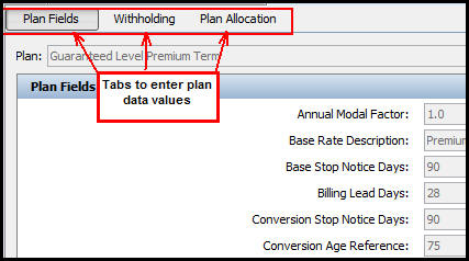

Plan Data has three panes: Plan Fields, Withholding and Plan Allocations. The fields that display on each pane can also be edited.

Plan Data Tabs
Plan Data Tabs
