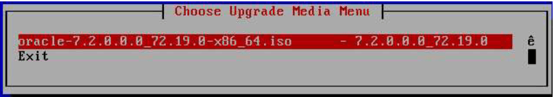

admusr@<ora-guest-ip>:/var/TKLC/upgrade
3.5.5.2.1.5 IDIH CLI: Start Oracle Guest Upgrade
3.5.5.2.1.6 IDIH CLI: Monitor Upgrade Progress
$ tail -f /var/TKLC/log/upgrade/upgrade.log
