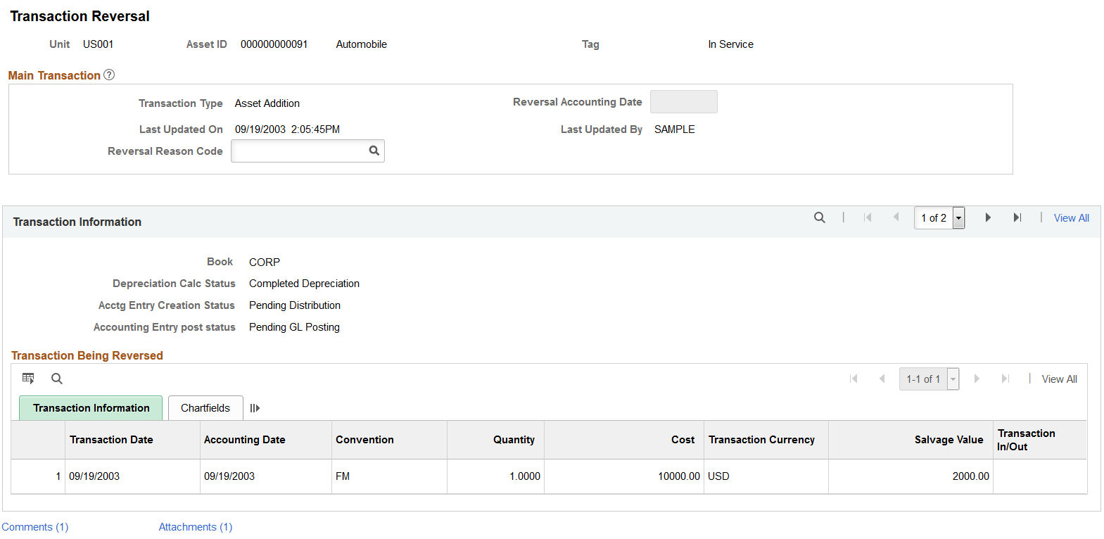

Use the Transaction Reversal page (AM_TXN_REVERSAL) to enter the parameters for the reversal and generate the reversal transaction.
Navigation:
This example illustrates the fields and controls on the Transaction Reversal page. You can find definitions for the fields and controls later on this page.
To reverse a transaction, use this page to enter the parameters for the reversal, then click Save. You must click Save in order for the transaction to be reversed.
Field or Control |
Description |
Transaction Type |
Displays the transaction type for the transaction you are reversing. |
Reversal Accounting Date |
Enter a reversal accounting date. The system displays the current system date initially, but you can modify the value. |
Reversal Reason Code |
Enter a reversal reason code for this reversal. Reversal reasons are defined on the Reversal Reason page (AM_REVERSAL_REASON). If you selected the Reversal Reason Required option on the AM Business Unit Definition page, this field will be required. |
Book |
Displays the book associated with the transaction being reversed. |
Depreciation Calc Status (Depreciation Calculation Status) |
Displays the status of the depreciation calculation. Note that transaction reversal can only be performed on assets for which depreciation is already processed. |
Acctg Entry Creation Status (Accounting Entry Creation Status) |
Displays the accounting entry creation status. |
Accounting Entry Post Status |
Displays the accounting entry post status. |
Transaction Being Reversed
This section displays details of the transaction being reversed, such as cost, currency, department, and so forth. Click the Save button to reverse the selected transaction.
Transaction Reversal Created
This section provides a preview of the transaction reversal that will be created and displays reversal details, such as costs and quantities reversed. You must still click Save in order for the transaction to be reversed.
You can view additional details about the reversed transaction using the Review Reversal Transaction page.
Note: This section does not display when reversing initial Asset Addition transactions.

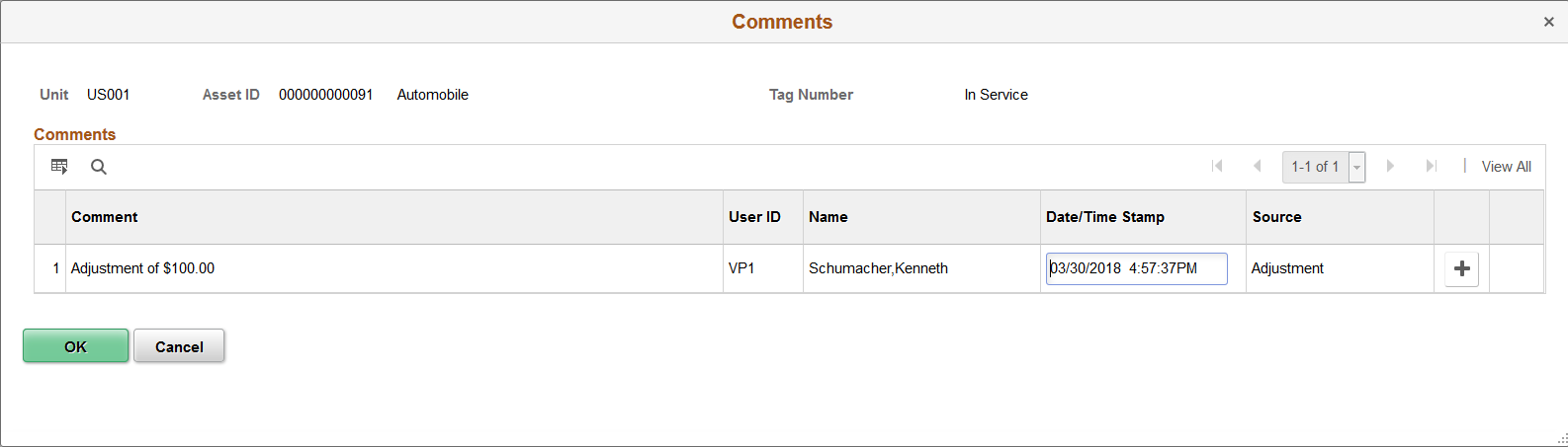

Adding and Reviewing Comments
Click the Comments link to access the Transaction Reversal - Comments (AM_COMMENTS_SEC) page and view or add relevant supporting comments to an asset transaction.
This example illustrates the fields and controls on the Transaction Reversal - Comments page.
Field or Control |
Description |
Comment |
Enter comments for an asset. |
User ID, Name and Date/Time Stamp |
Displays the user ID, name, and date/time stamp related to the user who added the comment. You can edit the date/time stamp after saving the comment. |
Source |
Displays the transaction source for the asset, such as adjustment, transfer, and so forth. |

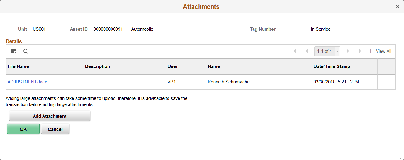

Adding and Reviewing Attachments
Click the Attachments link to access the Transaction Reversal - Attachments (AM_ADD_ATTACH_SEC) page and view or add relevant supporting documents to an asset transaction.
This example illustrates the fields and controls on the Transaction Reversal - Attachments page.
Field or Control |
Description |
Add Attachment |
Click this button to attach files as supporting documentation for an asset. Supply a description of the file or files that you attach. |
File Name |
Displays the attached file. Click the file-link to access the file. |
Description |
Displays a description of the file attachment when one was provided by the user. |
User, Name, and Date/Time Stamp |
Displays the user ID, name, and date/time stamp related to the user who added the attachment. |

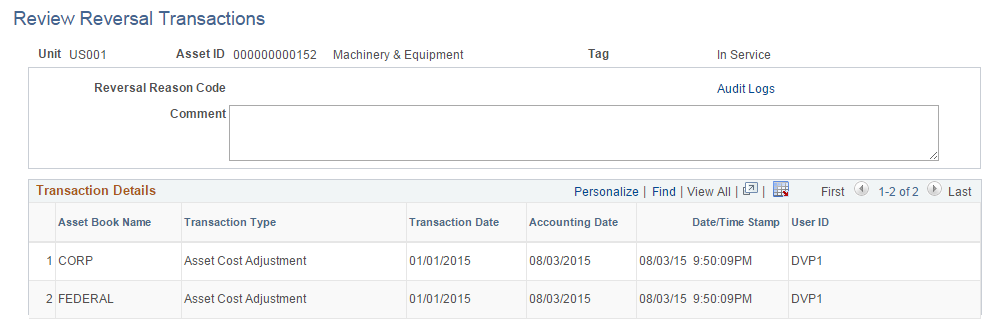

Use the Review Reversal Transaction page (AM_REVERSAL_REVIEW) to review details about a reversed transaction.
Navigation:
This example illustrates the fields and controls on the Review Reversal Transaction page. You can find definitions for the fields and controls later on this page.
This page displays details for a reversed transaction, such as the corresponding asset book, transaction type, and user ID of the individual who performed the reversal.

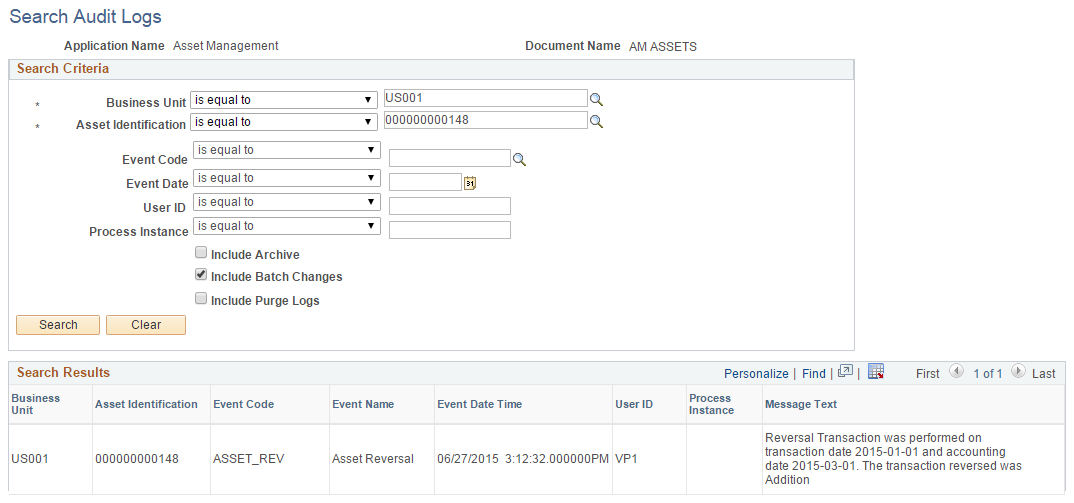

Click the Audit Logs link to access the Search Audit Logs pagelet and view detailed audit information for the reversed transaction.
This example illustrates the fields and controls on the Search Audit Logs pagelet.
